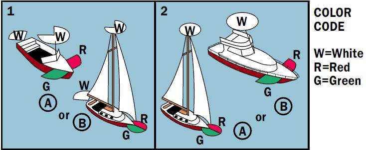

A "masthead light", often called a steaming light, is a forward facing light (225 degrees) used when motoring. Not the same as a 360 degree anchor light.
A masthead light is not necessarily at the top of the mast.

Not to take this too far but I don't think there is anything in the regulations about it being at "the top of the mast", be it a power or sail vessel.
But of course, you don't need one if you are under sail only.
Rule 21 (Definitions)
(a) "Masthead light" means a white light placed over the fore-and-aft centreline of the vessel showing an unbroken light over an arc of the horizon of 225° and so fixed as to show the light from right ahead to 22.5° abaft the beam on either side of the vessel.

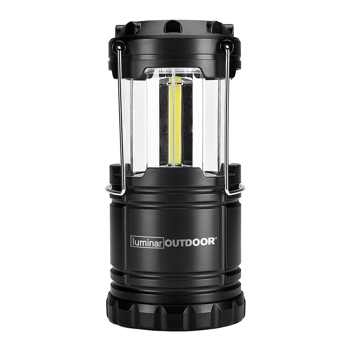

Yep. Get a couple LED lanterns. Dirt cheap, last forever. Hang them way up on a halyard, from the speaders, or the boom. Hang two for better visibility. You need 360° visibility. I also like to ensure they can see my boat, so one that shines down as well as out. The disposable battery ones work fine, but I like the rechargeable. No mucking about with spare batteries. I use them as interior/cockpit lanterns when not at anchor.

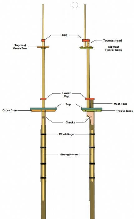

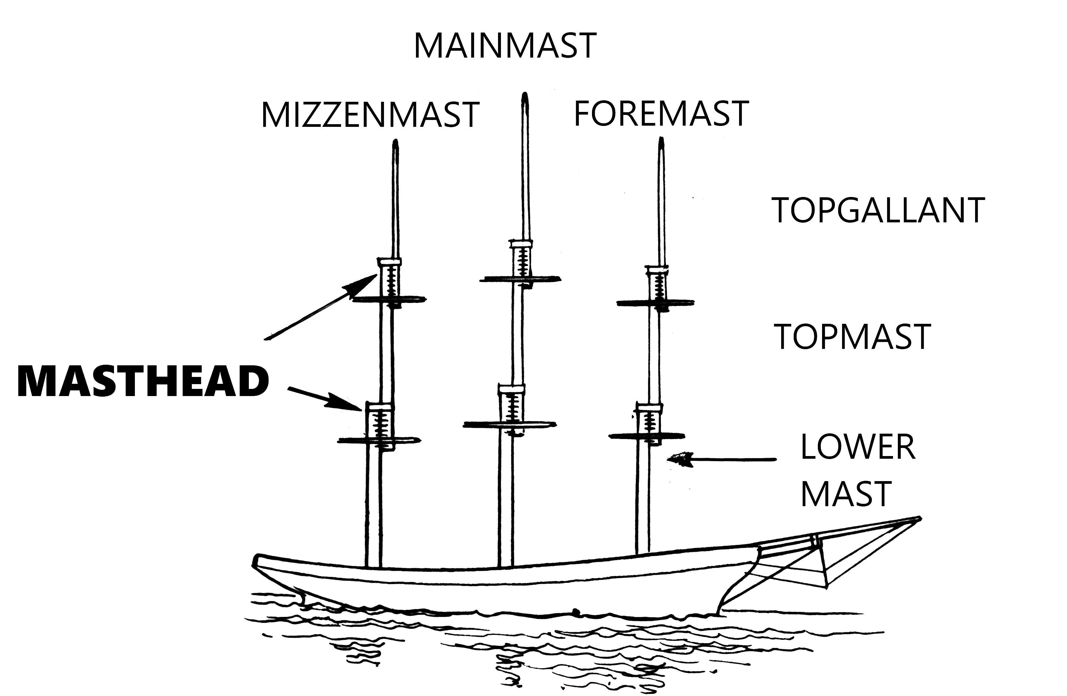

Close.
The masthead is the top of a lower mast on a traditional schooner or fully rigged ship. It is not the top of the entire mast.
The term frequently misused.
