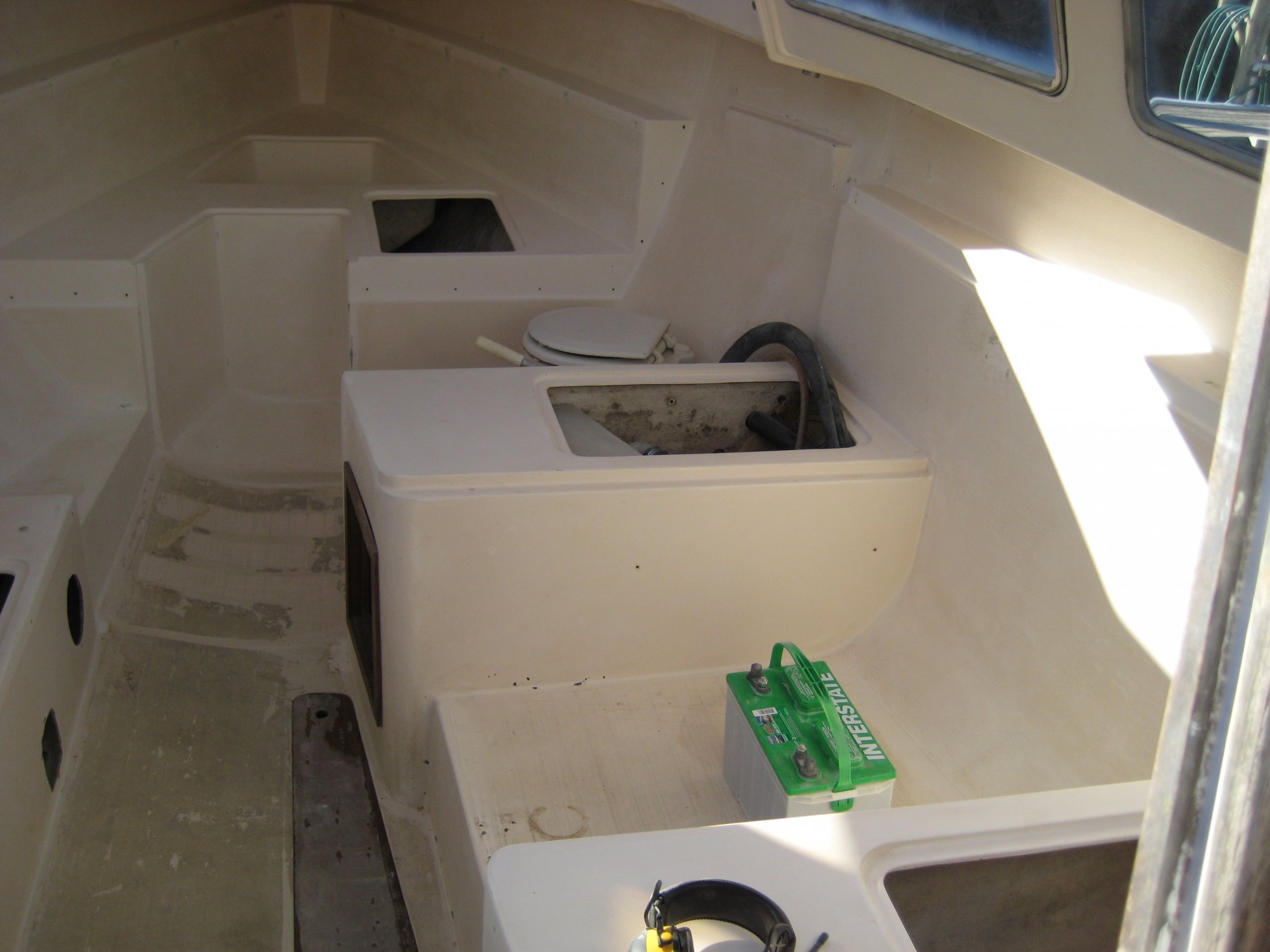

Any tips tricks to not get shat on? It’s a pump toilet with 3 way lock valve that connects to tank and pump out. I need to remove it temporarily to paint behind it.
No pumping station and it doesn’t appear to be draining when I open the valve. The tank still fills heavy as if it has shit in it ‘literally’
Yes I‘ll be safe and wear a plastic bag over my head duck taped around my neck to avoid the Hep.

Oh for heaven's sake...he's only moving the toilet out of the way, not the whole system!
First, close the intake seacock, then flush a lot of clean water through the toilet to rinse it out. If your tank is too full to do that, pump out the tank first. Then remove both the intake line and the discharge line from the toilet (warming the hoses a bit makes that a lot easier, just don't overheat 'em. I always used a blow dryer.). Put a plastic waste basket liner under the connections to catch any drips....you can stuff paper towel into the fittings and the ends of the hoses. Back out the mounting bolts and pick up the toilet. Done.
To put it back when the paint has dried, do it all in reverse.

If you just want to paint behind it, loosen the bolts that hold the whole thing down to the floor of the boat, inch it enough to get the paint on the wall, and put it back. No need to pull hoses, etc.
But you probably should fix it if you want to use the boat. Standing stuff in the toilet isn’t normal, and won’t smell very good.

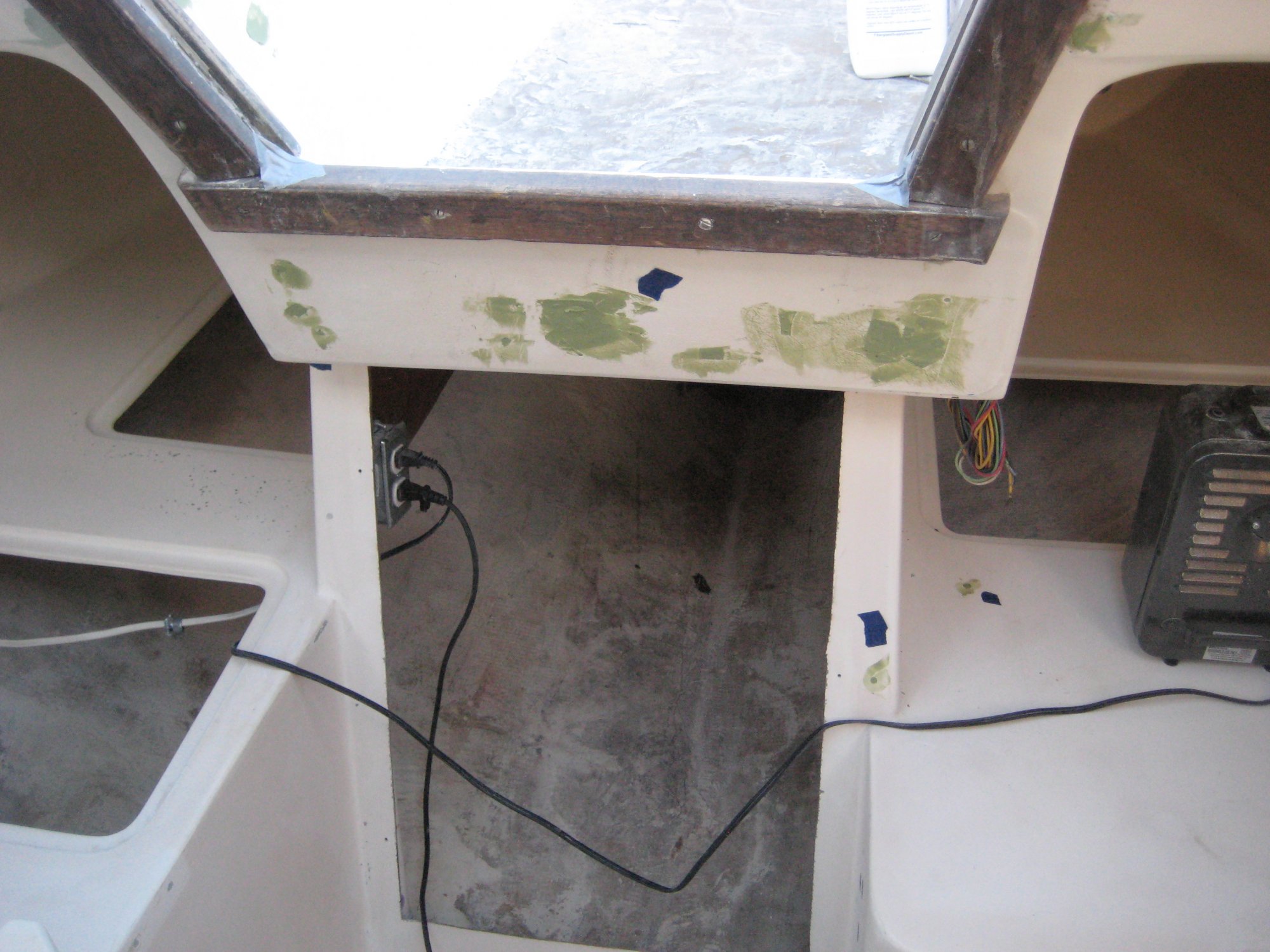

Oh and I completely forgot to mention that I'm not going to be removing the toilet because I found that I have to disassemble it to take the two back screws out that hold it down, so I'll cover it, tape it up and paint around it with a brush it won't look as nice as being sprayed but it is what it is.
14,182
I'm almost afraid to ask, when the tank emptied, where did the contents go?
Also, that metal junction box for the 110 circuit needs to go too. Check the wire, if it regular household Romex, it too needs to be replaced with stranded marine wire. A plastic box is fine, not metal and no wire nuts.
