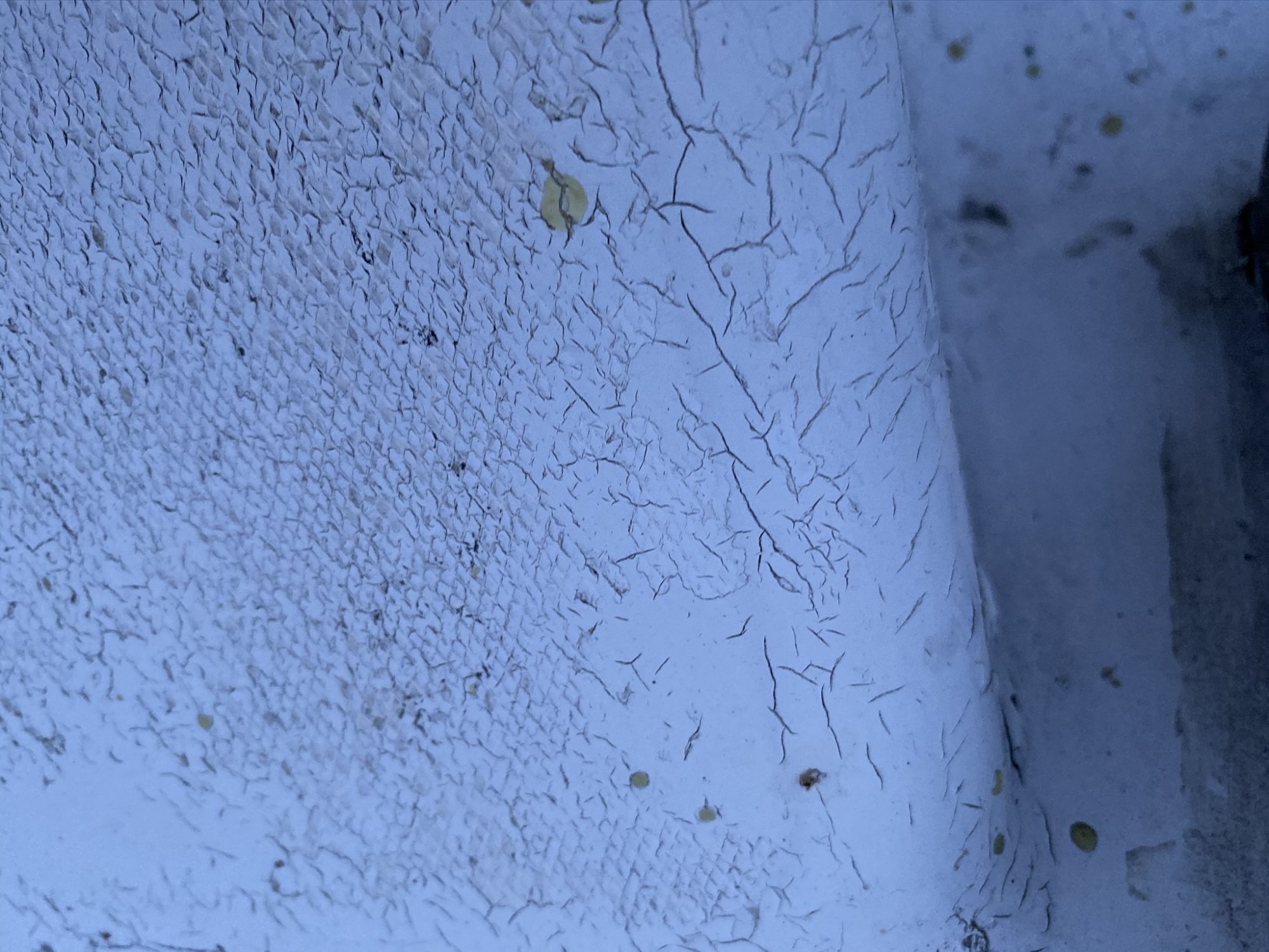

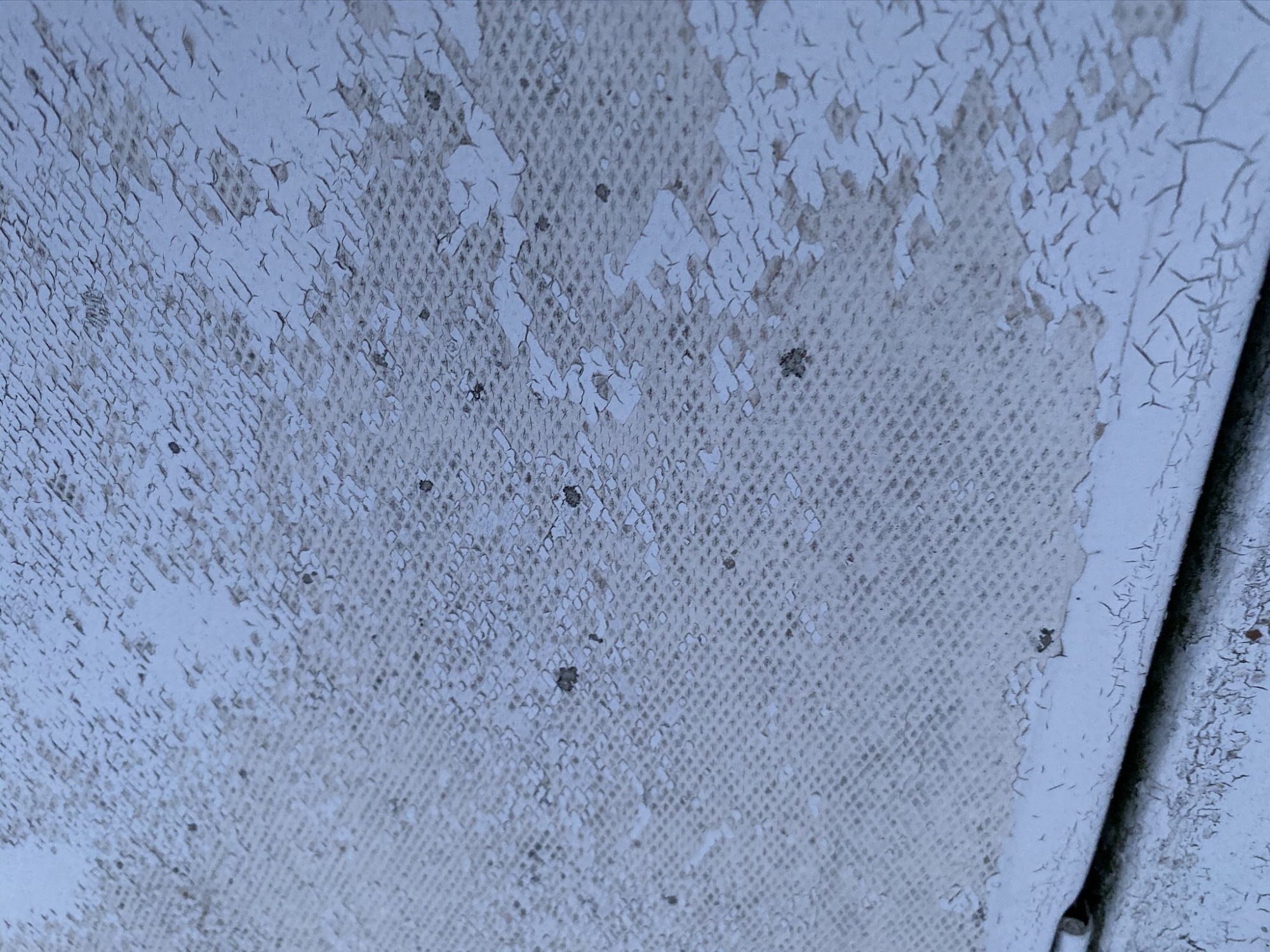

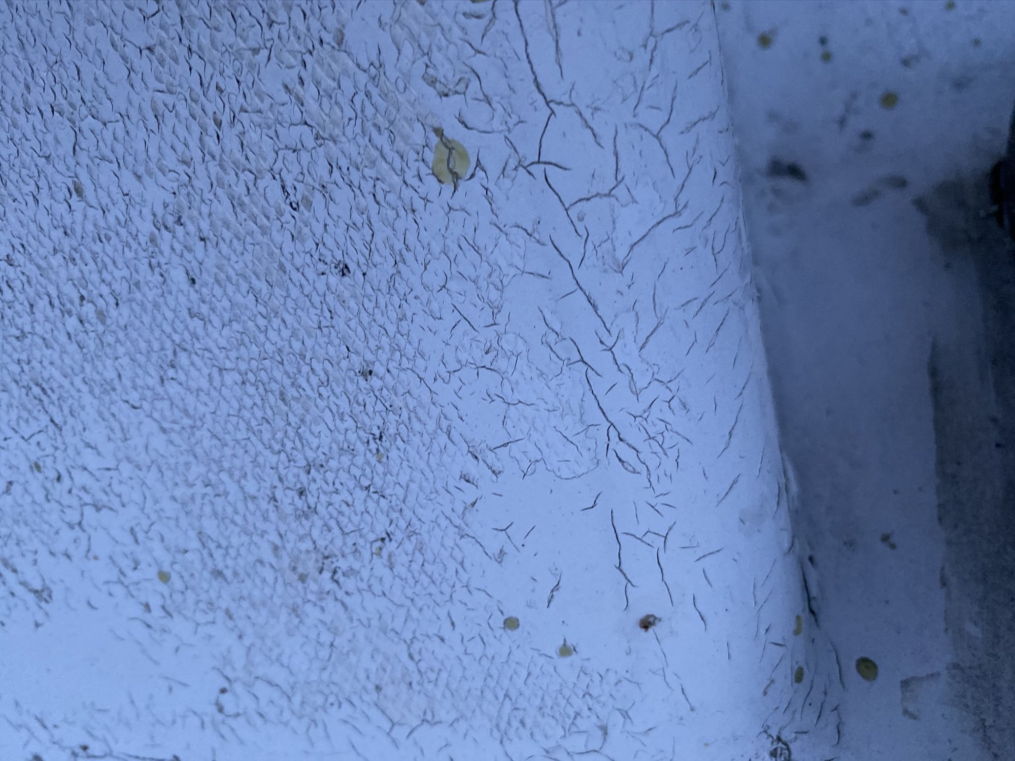

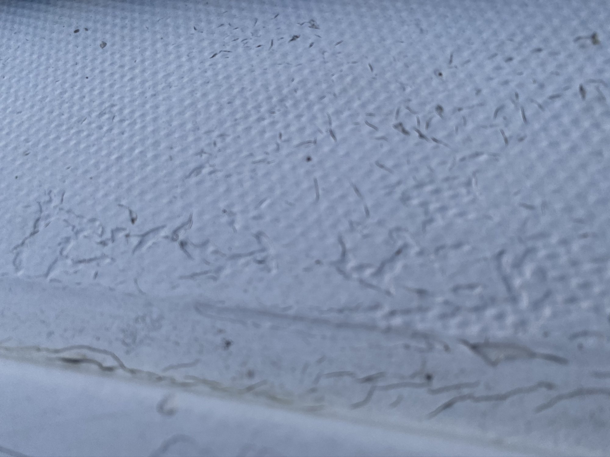

here are some more pics posted of the boat deck. I need to get back to the boat to get more close-ups. The previous owner just said to sand it a little to get the flakes off and it should be fine with a coat over it. Based on your advice from above I am starting to think it needs a more thorough job....

First of all, the "top sides" means the hull sides above the waterline and not the deck. Based on the photos, hardware removal comments, etc., I assume you mean the deck. Set the nonskid aside for now. You need to sand everything smooth so it is completely "frosty" in appearance (no shiny surface) and not just sand the "chips" on the smooth parts of your deck. You should clean the deck to make sure all waxes are off, so you are not sanding wax into your sanding grooves. The sanding of the deck not only smooths it out, but it gives the next coat of paint a "tooth" to attach itself. If there are shiny spots, then that is where the paint will chip off later on because of poor adhesion. Next you need to apply a primer for whatever paint you choose to finish with. The primer will more so help with the adhesion of the top coat paint you choose. Then you apply the color of the paint compatible with the primer. If you apply a really smooth coat of primer, there will most likely be a window when you can paint over the primer without sanding. But, if your primer surface is rough, then you need to let it cure and then sand it smooth (but not off) before applying the top coat color. When painting, two or more thin coats is better than one thick coat. Technique will vary upon whether you are rolling/brushing on the paint or spraying it on. Paint selection has to do with color choice (you said white, so most any paint will have white). There are one part paints that are cheaper (like Interlux Brightside) or two part paints (like Interlux Perfection or Awlgrip/Awlclear). The latter are linear polyurethane paints and the Awlgrip product is used by pros. Whatever you choose, read the instructions on the label carefully and stick with recommended products.

I forgot the nonskid. There are a number of nonskid paints available, like Interlux Interdeck, which is premixed with the grit in a flat paint application (not shiny). You don't want to apply a shiny paint - even if it has grit in it - to a deck as the shiny part, when wet, will still be slippery. So get a paint like Interdeck, Kiwi Grip, or something already mixed, or add a flattening agent to your shiny paint to make it not shiny so it is safe underfoot.

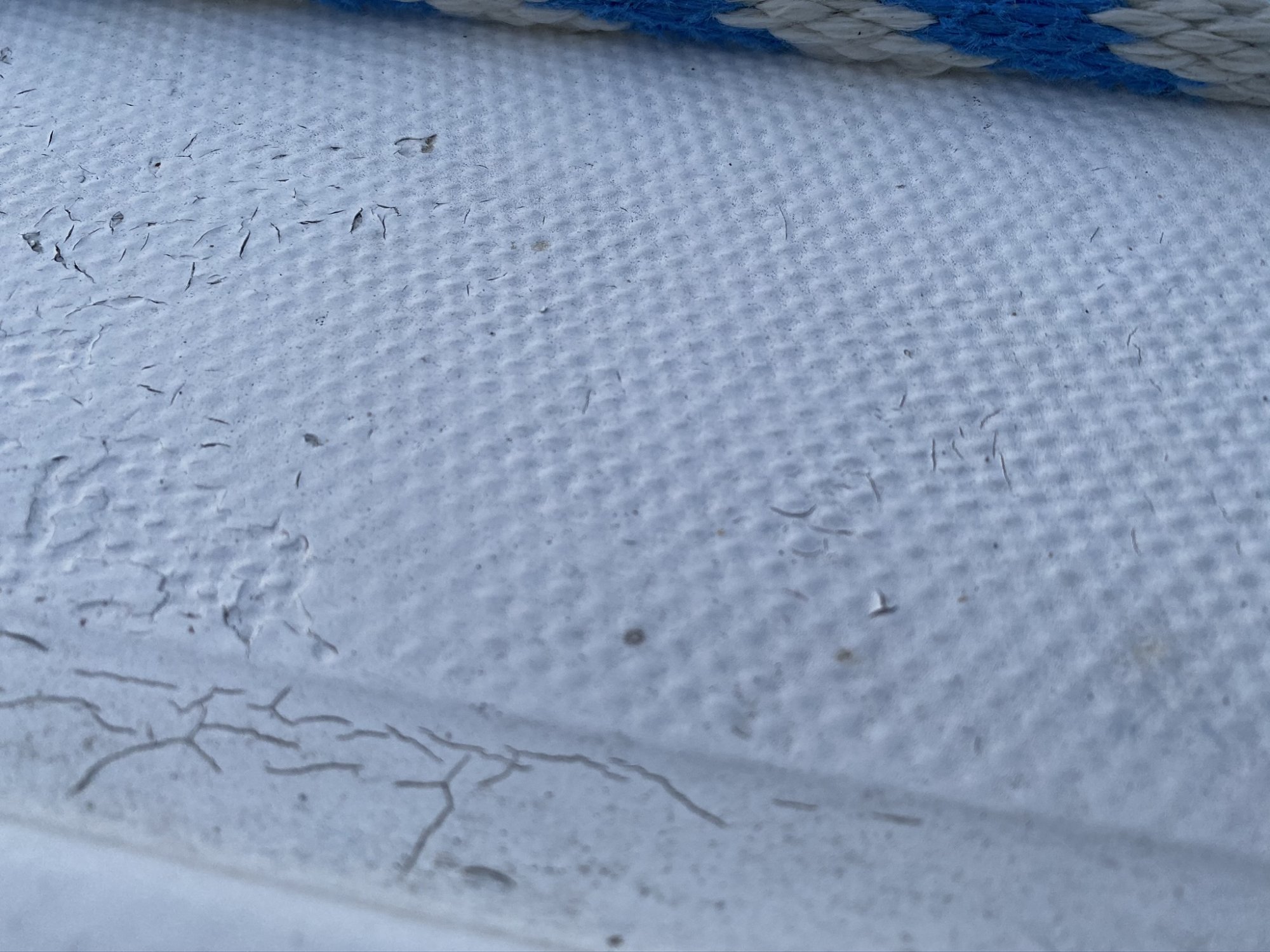

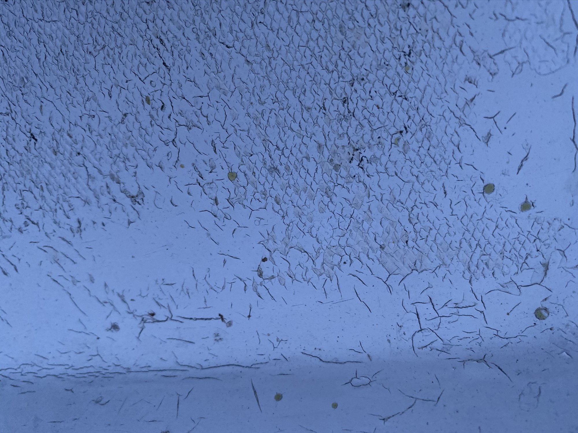

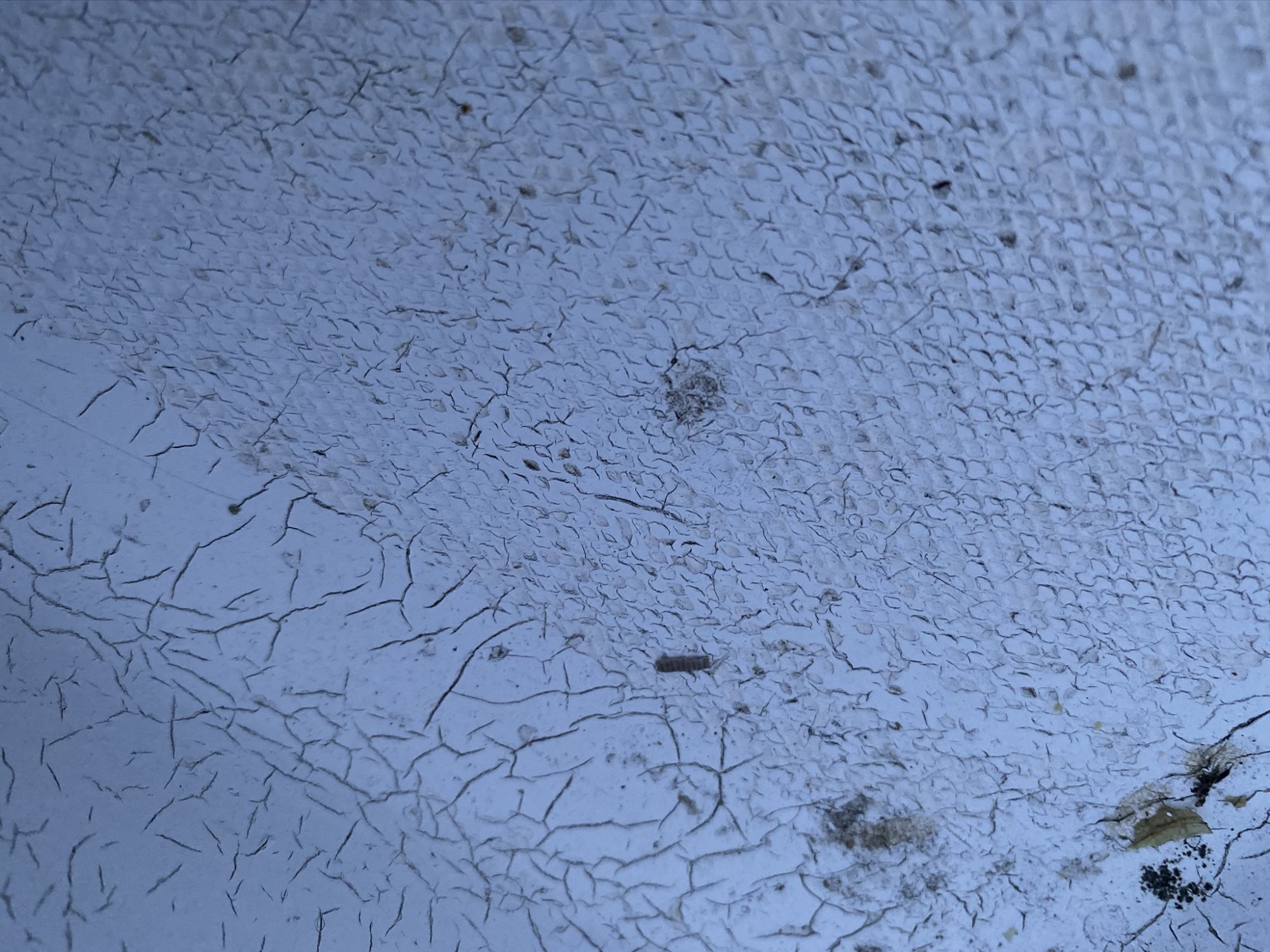

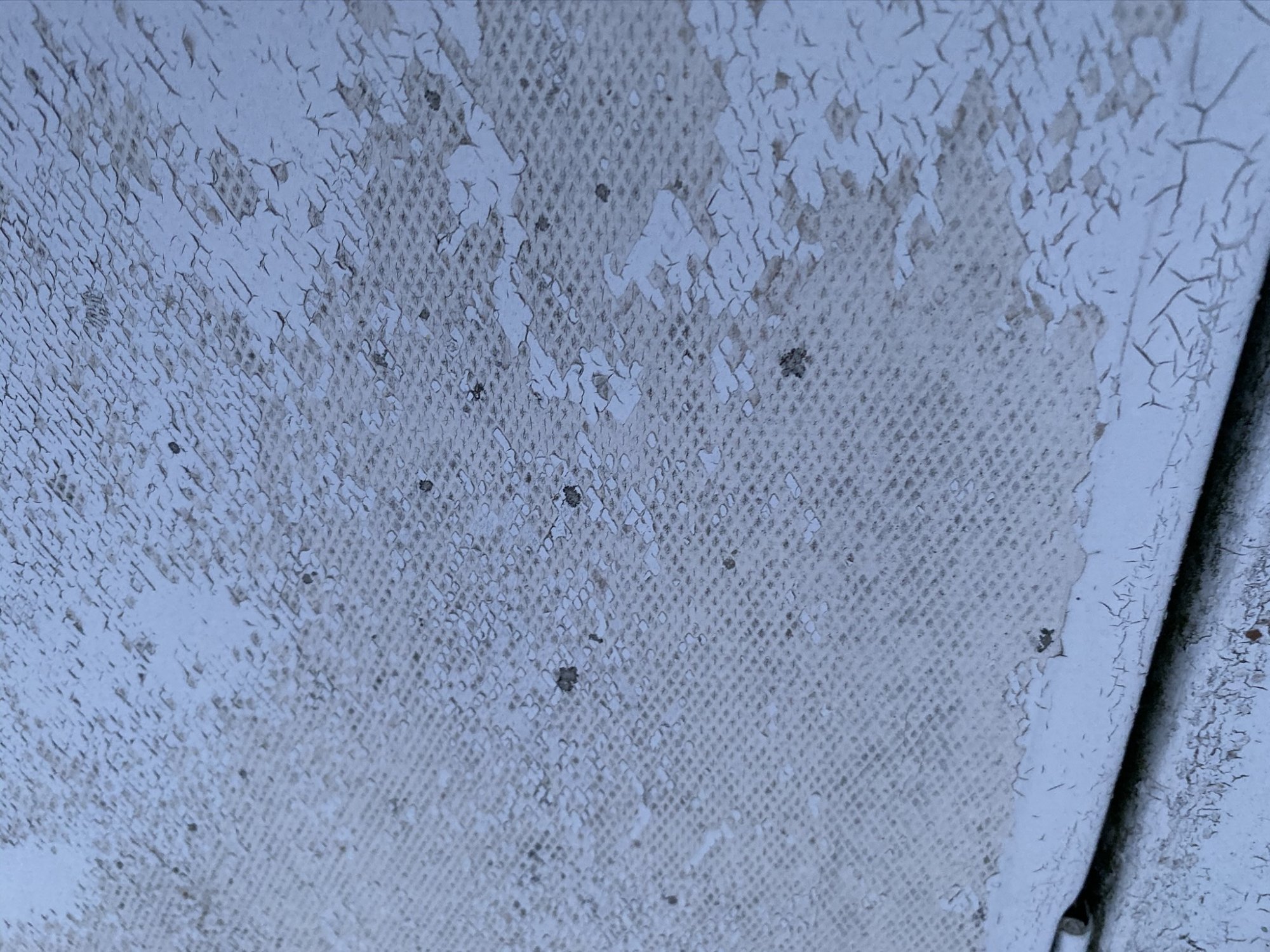

Hi everyone. Thank you for your advice. I took some close-up shots of the deck to get more feedback. It looks like the deck was painted with normal marine paint across the whole deck. A nin-skid surface was adhered to the deck and the normal paint was painted over it. Please take a look at the photos. I am still trying to come to a conclusion on how I want to paint the deck in the spring.

Unfortunately, that all has to be removed. Sand down to smooth gelcoat and start over. There are many ways to apply new non-skid. Kiwi Grip and Soft Sand are two that come to mind that yield good results.

This is where you begin learning about boats.. :) I did... When you say 'normal marine' paint.. what does that mean?...looks like they used the wrong paint type. Looks like It will have to be removed to do it correctly. I think you'll need to know what paint was used.. looks like 1 part and didn't prep the gel coat correctly. You should consult a professional.. any marine paint manufacture has a technical support line that could help confirm your approach. Also, get/borrow and moisture meter and check the deck.. and whole boat. ..look for soft/spongy spots around your chain-plates and through hulls. As I suggested with the handle of a screw driver and get those repaired. The C-22's are fairly easy to see whats going on the back sides of those mountings when you get inside the boat. There are Lots of youtube video's on this stuff. My first thought is to look into 'Soda blasting'. If you are handy you can do that yourself. It will require setting up an area where you can work. I would not worry about any fine pitting that might cause (if that is a concern) the primers and 2 part paints will fill those in. ALSO, Once again sorry to sound like a broken record... but you'll need to inspect your swing keel and the pivot point.. that's 450+ lbs of dense iron/lead hanging on a hole within 2" of the edge of the keel. If that breaks loose while sailing that will make of a very very VERY bad day. It's no east task to drop that either. Unless you have a friend with a sling and the means to lower and raise a very dense 450+ lb slab of iron/lead it will cost you to raise and drop it. ( maybe $225 a each time) Plus the cost, time to fix it.. you can do it yourself.. I did ..but it took and engine lift, a hydraulic scissor table lift (500 lbs capacity) and I built a jig to hold it.. I have pictures to share when you get to that point.
