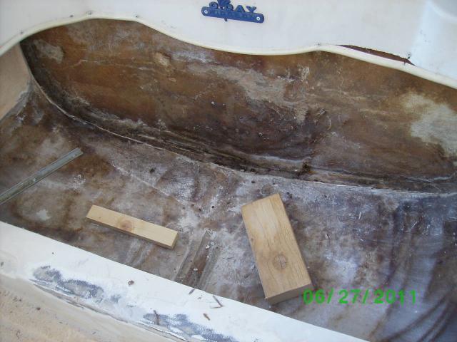

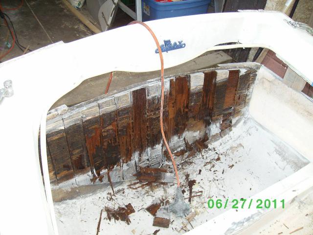

I recently bought a 1964 O’Day Widgeon. The seller had it in his yard for over 10 years collecting water and all sort of debris.
I started the clean up and decided to install inspection ports on the bow compartment and the stern. Both were filled with water soaked foam that.
The problem is I noticed that the transom wood is rotted from all the water that soaked in that compartment for years and need help with ideas of what to do next.

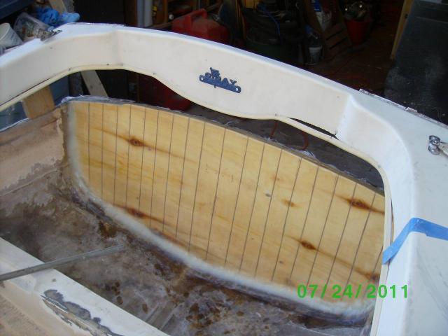

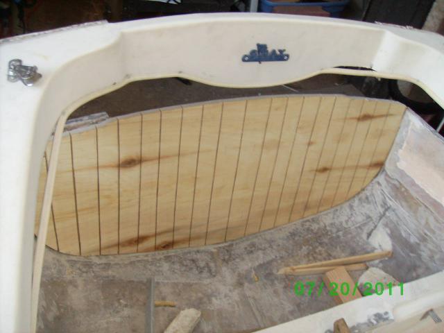

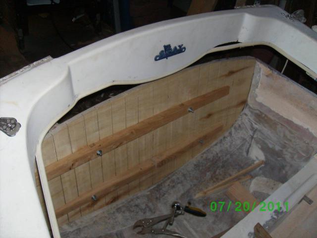

Here are some pictures of the work so far. I used 3/4" exterior plywood and scored it to be able to shape it to the outer skin of the transom.
After it was set in with thickened epoxy, I filled in the scores with thickened epoxy and covered the whole face with 8oz FG.
I still need to figure out how I will reattach the deck, not sure if I should used epoxy or some other type of glue. The original set up had staples that attached the deck to the hull. Since I don't have anything that can drive staples through FG, I'll have to come up with a different solution.
I would appreciate any input.
