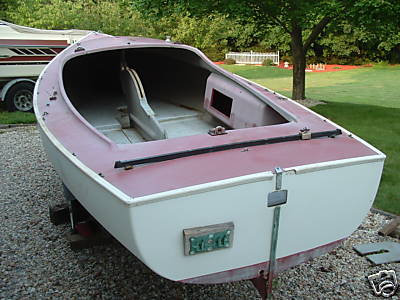

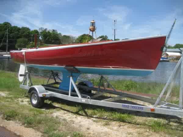

I recently bought an R19 keelboat #63 with sail #67. It has No floortimbers (ribs), or floorboards and there is no visible evidence that it ever did, although I've been told it must have at one time. So now I believe that I need to install these (or what?!?); I can buy either foam or oak "timbers" from Stuart for $395, but floorboards are $1850 (mahogany), or $2650 (teak)!!! Out of the question. I have acquired sufficient teak to make floorboards but lack a pattern - does anyone in SC own a keel version R19 I could trace a pattern from?
Should I install foam (lots more fiberglassing required), to add flotation & save weight - or go with the oak because it's easier to install?
New sails: jib or genoa? (Installing a CDI furler.)
Any other suggestions? Hull & deck just Awlgripped and look great...

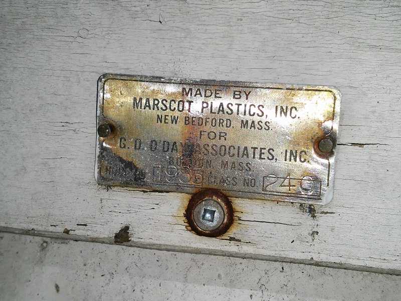

Thanks! Still trying to determine if the "2 63" #s on the bronze plate mounted inside the splash rail refer to month & year built or something(?) & hull #...
As yet am unable to read anything else off the plate (like builders name).

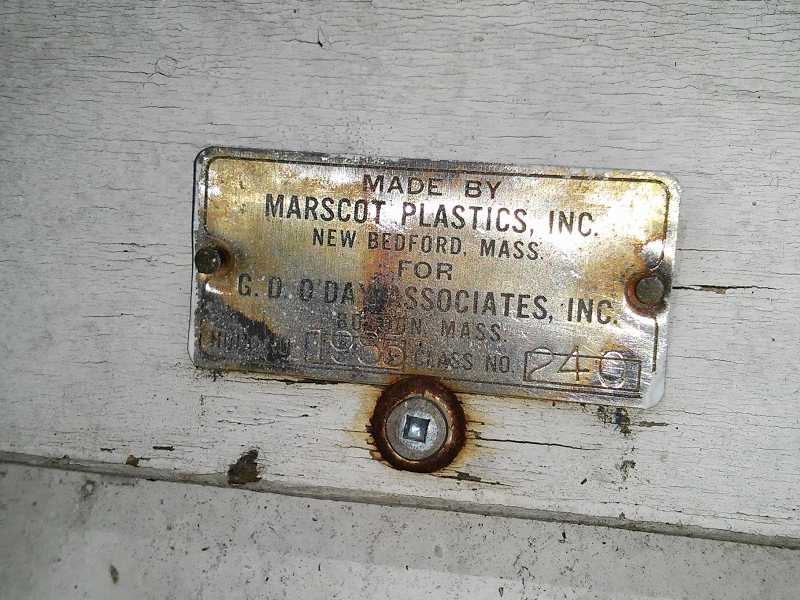

Well, the early (before 1973) O'DAY boats all had a metal plate with 2 numbers on it, a HULL# and a CLASS#. Hull# referred to how many total boats O'DAY had built (all classes) and CLASS# referred to how many of that Class (Rhodes 19 in this case). So, although I have hard time imagining this....... It is not out of the question that you might have O'DAY Hull#63 Class# 63. I think that the R19 may have been the first design that George O'DAY had built by MARSCOT (even though many claim the Day Sailer was the first O'DAY model, but my research indicates that the R19 came first) and so, you MIGHT (???) have the 63rd R19 built, and if only Rhodes 19s had been built up to that time, the 63rd O'DAY boat built. Certainly not out of the question? I'll attach a picture of the ID Plate from an early Day Sailer as an example. As I say, seems too strange to be true...... but it is not out of the question that you stumbled on to a "treasure"?

Wow - thanks for that. I'll have to try to decipher the rest of the info on the badly "patina"d plate. Once again, however, the two numbers are "2" and "63". Not sure how that translates via your formula... guess I'll have to continue investigating. Thanks very much for you feedback!

Oh, I misunderstood, thought you were saying both numbers were "63". Oh, well! It will be interesting to see if any more digits are visible on that plate.

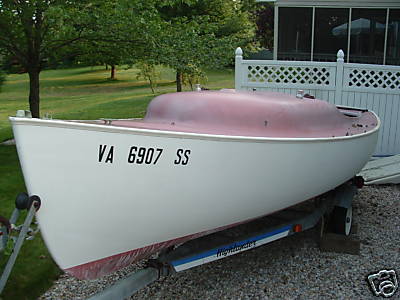

Startling Update!!! After consulting with Wendy Goodwin, pres. of Cape Cod Shipbuilding, I can report that we now believe that the boat is in fact not a Rhodes 19, but rather a Rhodes 18 that was built by them in mid-60's.
This explains the "missing" timbers and floorboards, the R18 did not have them! The similarities between the two boats are such that they can easily be mistaken for one another, as was the case with the boatbuilder who sold me the boat and believed it to be an R19, and myself, who simply didn't know better as a result of being far more familiar with other one-designs than with this particular one!
So, "mystery" solved - still a beautiful boat, and for what it's worth, a precursor to the R19. The original prototype!

Oh ,and you are not the first person to be told that they had a R19 when the boat was really a R18. Originally, the fiberglass R18 had a small cuddy, later eliminated, I think all the wooden ones (plank on frame) were, like the current FG ones, without a cuddy. Keel and Cb models were built (Still are!) I'm sure Wendy explained this, but for others.... if there is a "2" and a "63" on the builder's plate, that means she is the second R18 built in 1963.
