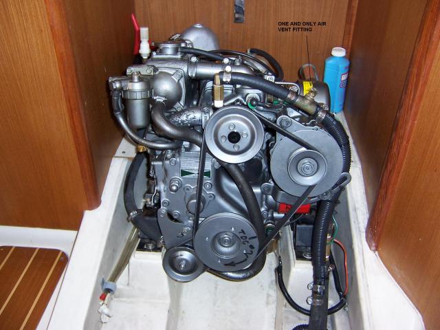

As others have said your sealed system is air bound. You may have a pet cock that looks similar to the one below located somewhere near the top of the engine. If you loosen it it will bleed the air so long as it is the highest point in the system.
It will look like this:
Here's an easy way to bleed.
1) Remove radiator cap.
2) Start engine and let warm up.
3) If fluid is low add some coolant.
4) Crack the pet-cock and allow the air to be purged from the system and close it as it burps out.
5) Wear gloves and use a rag when cracking the pet cock as it will be hot.
6) With the engine circulating fluid, and the cap off, top up the radiator fluid and re-install the cap.
7) Depending upon how much fluid you lost it is sometimes quicker to remove the t-stat, put antifreeze right into the t-stat housing until full, re-install the stat with new gasket, and then circulate and purge as above..
Because I change my antifreeze on a regular basis I installed a set up with a 1/4 turn ball valve and a PVC hose that automatically becomes the highest point in the system.
it sure makes bleeding air, and topping up the system as easy as it gets. Dex-Cool antifreeze HATES air and the two can wreak havoc on the engine internals:
This is how I purge air now (one of the neatest and most handy little tricks I have come up with;)):
23,526
And the hose from the valve
goes where?
Nice illustration. The M25 series have the same petcock on the top of the thermostat housings, too. My link to the burping includes the suggestion to fill both lines from that housing. If you're changing your thermostat, too, at the same time, fill 'er up right from there, good idea.
Feb 6, 1998
11,772
goes where?
It is just zip tied to the HX for my refrigeration and it is aimed at the engine sump when not in use. I purposely left it long enough to make it useful. When I need to use it I simply cut the zip tie and stick the end into Coke bottle or similar and crack the valve..
Yeah, it just dawned on me one day that we use similar valve/vents on hydronic heating systems so why not just use a quarter turn valve with a hose connected to keep it neater, easier and cleaner than the .59 cent pet cock... The hose also extends and creates the "highest point" in the system too. Works amazingly well.. Cost about $6.25..:eek: or about the same as the paper towels I'd use cleaning up spilled antifreeze..;)
