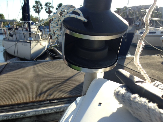

CD, are you saying a 135 wouldnt fit on the roller furler? not sure of the model, but this is the CDI bought the boat in May of this year. see photo
