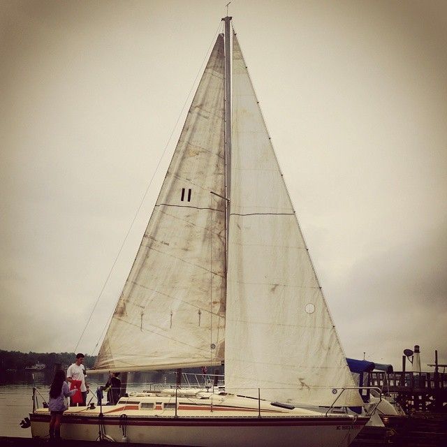

We have a 25.5 and are very new to the boat (and really to sailing in general). Hope you don't mind me posting in this thread - but I'm wondering how I can tell if my headsail is a standard jib, or a 110, 120, 130, etc.. Are there measurements online that I could check?
Or maybe one of you more familiar with the 25.5 might be able to tell from a picture:
She was pretty neglected before we got her. Here's what the sails look like all cleaned up:
