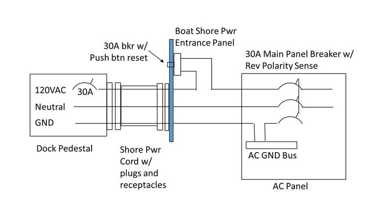

The AC circuit on our '91 H30 needs some work and I would like to get it as close to ABYC recommendations as possible. I will soon install a galvanic isolator at the boat entrance panel.
But I'm not sure what to do with the push-to-reset 30A AC breaker on the boat entrance panel that is corroding and becoming an I^2R fire hazard. I'm thinking of replacing it with a BSS two pole ECLI 30A breaker to get the whole boat protection. It seems to be an ABYC recommendation now. The main panel is about a 12-14 Ft run back to the boat entrance panel so ABYC seems to recommend placing the ECLI at the entrance panel.
http://catalog.bluesea.com/#63/z
I assume the ECLI is compatible with the galvanic isolator because the ECLI doesn't seem to trip until 30ma (I might be wrong). The GI is still a good idea if I had a small leakage to ground that was below the ECLI trip threshold of 30ma I would think.
Many thanks for your insights.
