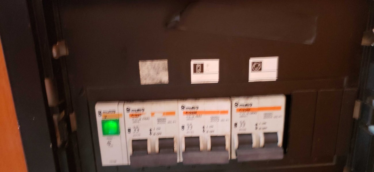

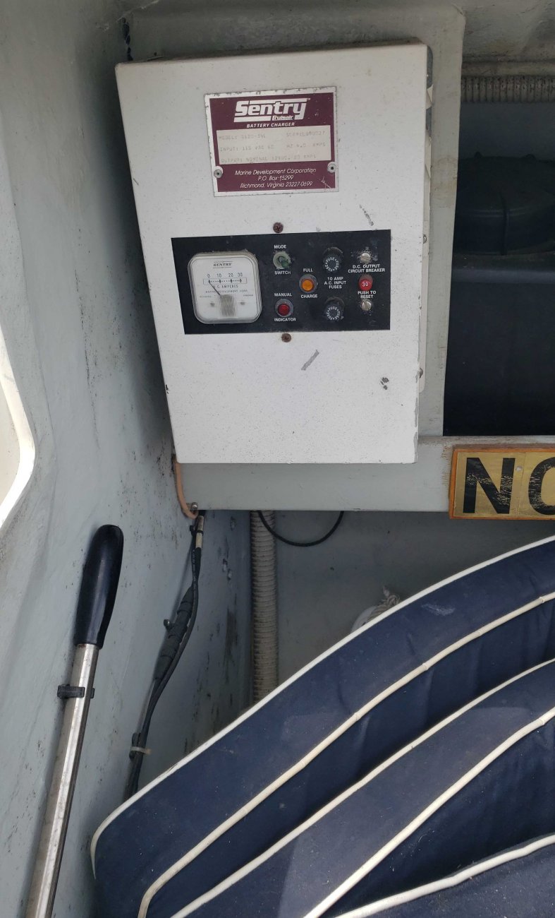

Trying to turn on the battery charger. It's a 1990 Beneteau 35s5. No switch on the charger. Looking for the 12 volt panel. Any ideas?

If you want to power the charger you’re looking for the 120V AC panel, not the 12V DC panel. They might be in the same place in any case, likely somewhere accessible in the cabin near a nav table or something. If the 120V breaker for the charger is on and the Charger still doesn’t start then more troubleshooting, likely with a volt meter, is required.

If your battery charger 120 volt breaker is on , check the fuses on the front of the charger, better yet I had the same charger and changed it out to Sterling ,way better charger and you might go faster ,that charger weighs a ton
