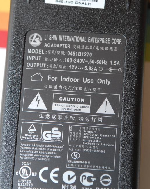

Sail Maine, I believe you
As a matter of fact, I can't believe that my 20" might be the same way at home. I might be able to us it instead of the 15" I have now.
Sorry for my reading. I know it is poor right now. My dog is dying of bone cancer and I have had a massive head since I found out.
I have been looking for a bigger TV for my boat and was hoping your idea of removing the wall wart would work. I just wanted to clearfy.

Alot of home electronics actually do run on 12vdc, most have internal transformers that drop 120ac down to 12vdc, a few have external power supplies that do the same thing. Not all of them will be 12v, but a huge amount of them are.
It's cheaper for the manufacturers, because the actual assembly line doesn't change, they just have to throw in the right transformer for the destination country, everything else stays the same.

Most items that are designed to run on 12v will run on a range of voltages from about 10.5v to as much as 18v in some cases. My father-in-law was an electrical engineer and we used to have deep discussions about the ranges and such that DC rated items will run on. Most of these conversations revolved around him finding items for our boat that would or could be run on 12V.
It was kind of a fun game for him and I learned a lot from him about how to read schematics and open things up and by pass a 120v circuit to get at the 12V side. He even built me a 12V cigarette lighter adapter for my laptop years ago, late 90's, and well before they were commercially available for the brand/model laptop I had.
My TV has seen low 12's with the occasional dip into the 11's with a big current draw like my vacuum running through the inverter. It has also seen the full output of my alternator and it works flawlessly.
From what I see on my boat I have a lot less fluctuation of voltage than I do at my house. I'm actually staring at my power conditioner for my TV/stereo system and in the last 15 minutes it has ranged from 116.4 volts to 122.3 volts. Right now it's 118.6.. At 6:00 p.m., when all my neighbors come home, it can dip into the 108 range! My boat is at least as steady as that if not more..

just be sure to read the warts or schematics. Many computers these days run on a 15, 18, 24 or other odd voltages, my Macbook being one of them.
You'd really hate to be chronically undercharging and undervolting a $200.00 laptop battery. While a 15 volt computer will probably run on a 12V source I'd be cautious. I don't dare to run my Macbook off 12V, and physically can't due to the MagSafe connector, so I purchased a very small inverter dedicated to only charging my camera batteries and the laptop but it is inefficient.
