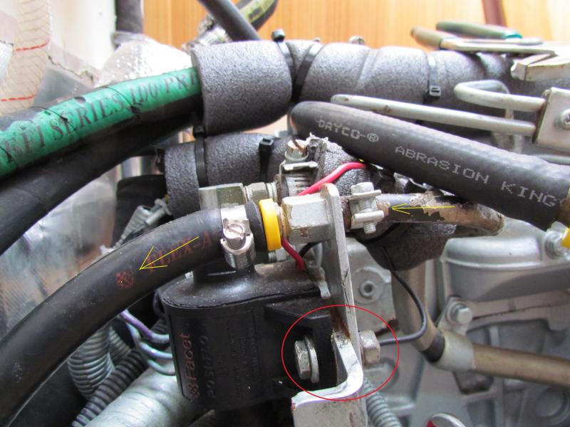

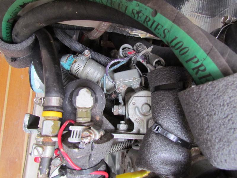

Mat, I believe you have a Catalina 310. What Universal engine? Most likely an M25XPB.
1. Yes. It's on almost if not all inboard engine Catalina sailboats of that size
2. No, it won't get hot, because the diesel fuel lubricates and cools the pump as part of the design. If it does get hot, it means it is either failing or the screen in the bottom has not been cleaned. In many cases, Catalina plumbed it wrong, by having the pump before the secondary filter. http://c34.org/bbs/index.php/topic,5078.msg32616.html#msg32616 You should read the rest of the items on that link, many of them relate to your engine. You should also read the C310 section of this website which has great info, too.
3. Your "machine would like..." Not sure I understand this one. The tank comes first, then the primary, then the pump then the engine. See #2.
4. Rarely, they last a long time. Resources for replacement have been mentioned, auto store is the least expensive for a Facet replacement, and there's always this: http://c34.org/bbs/index.php/topic,2515.msg32522.html#msg32522
