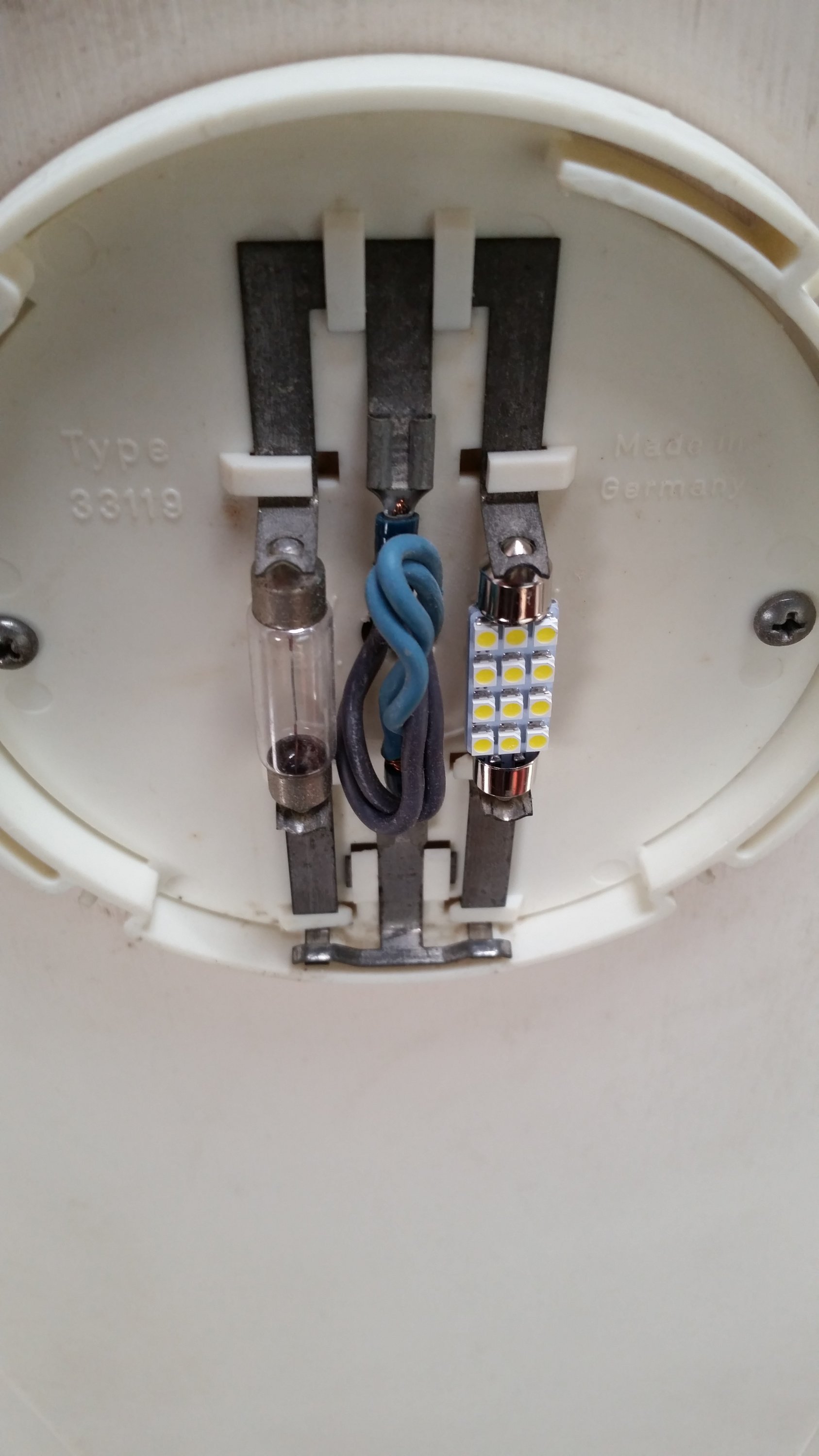

So I had already replaced the dome light bulbs with LED.

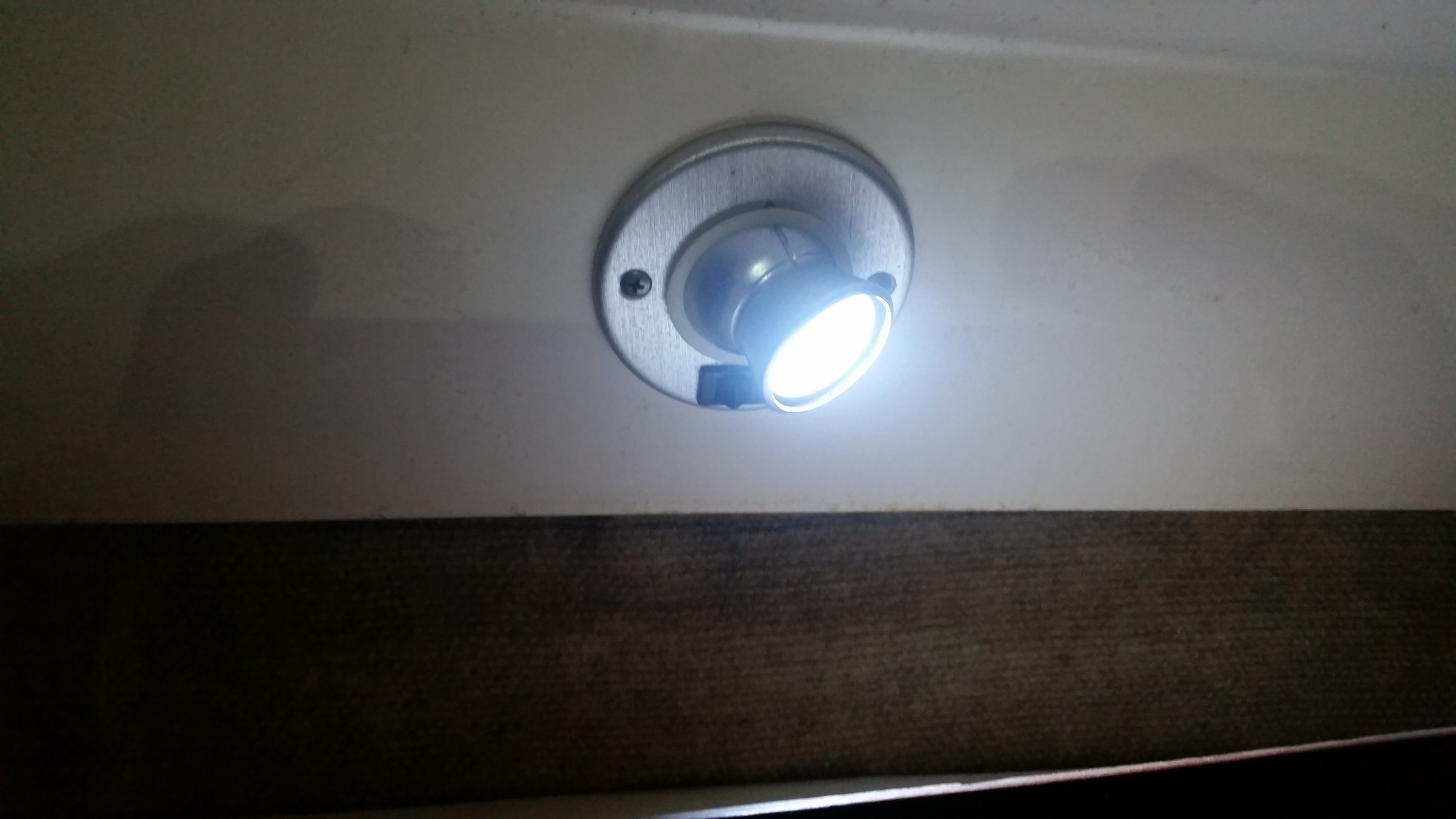

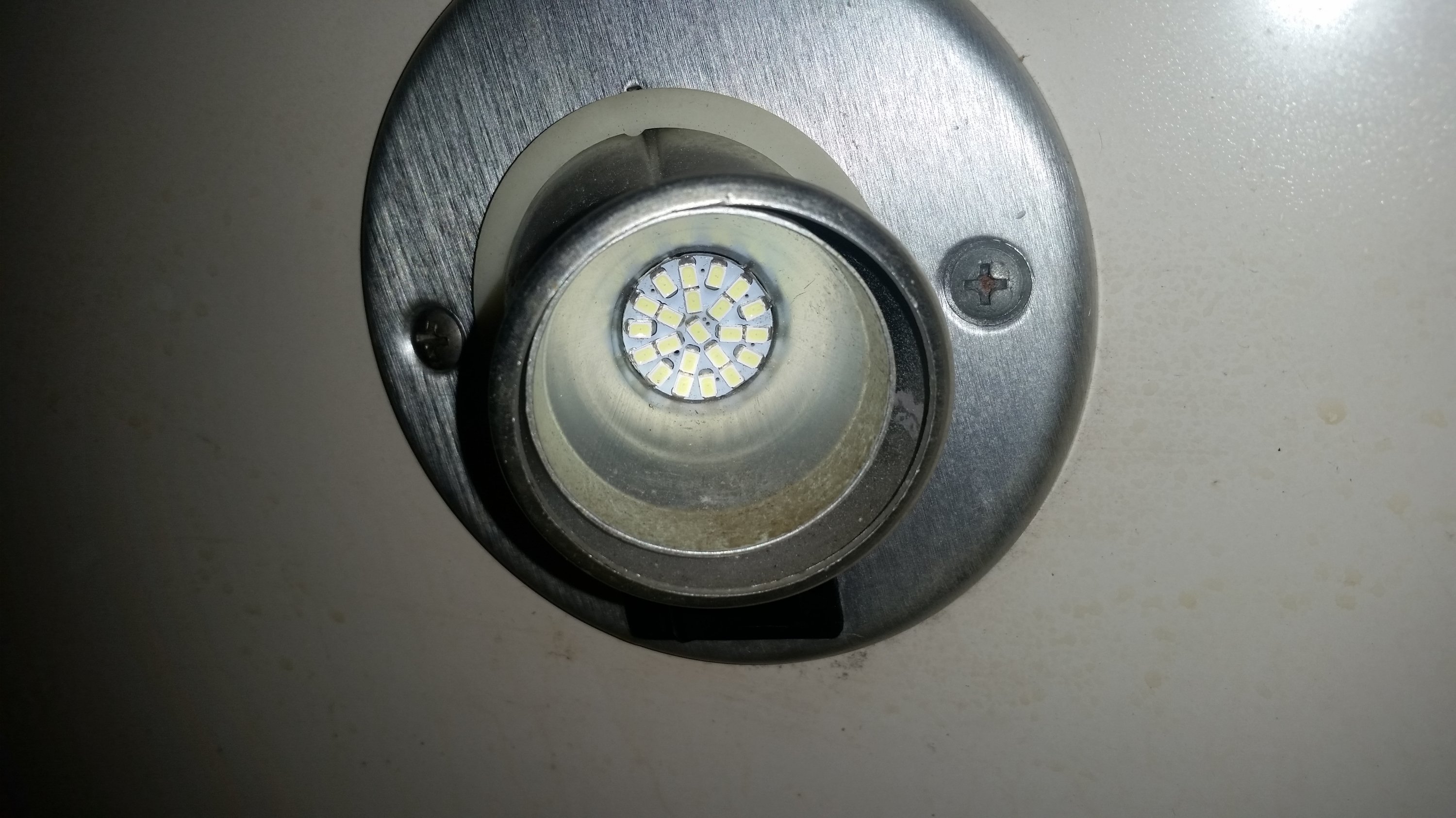

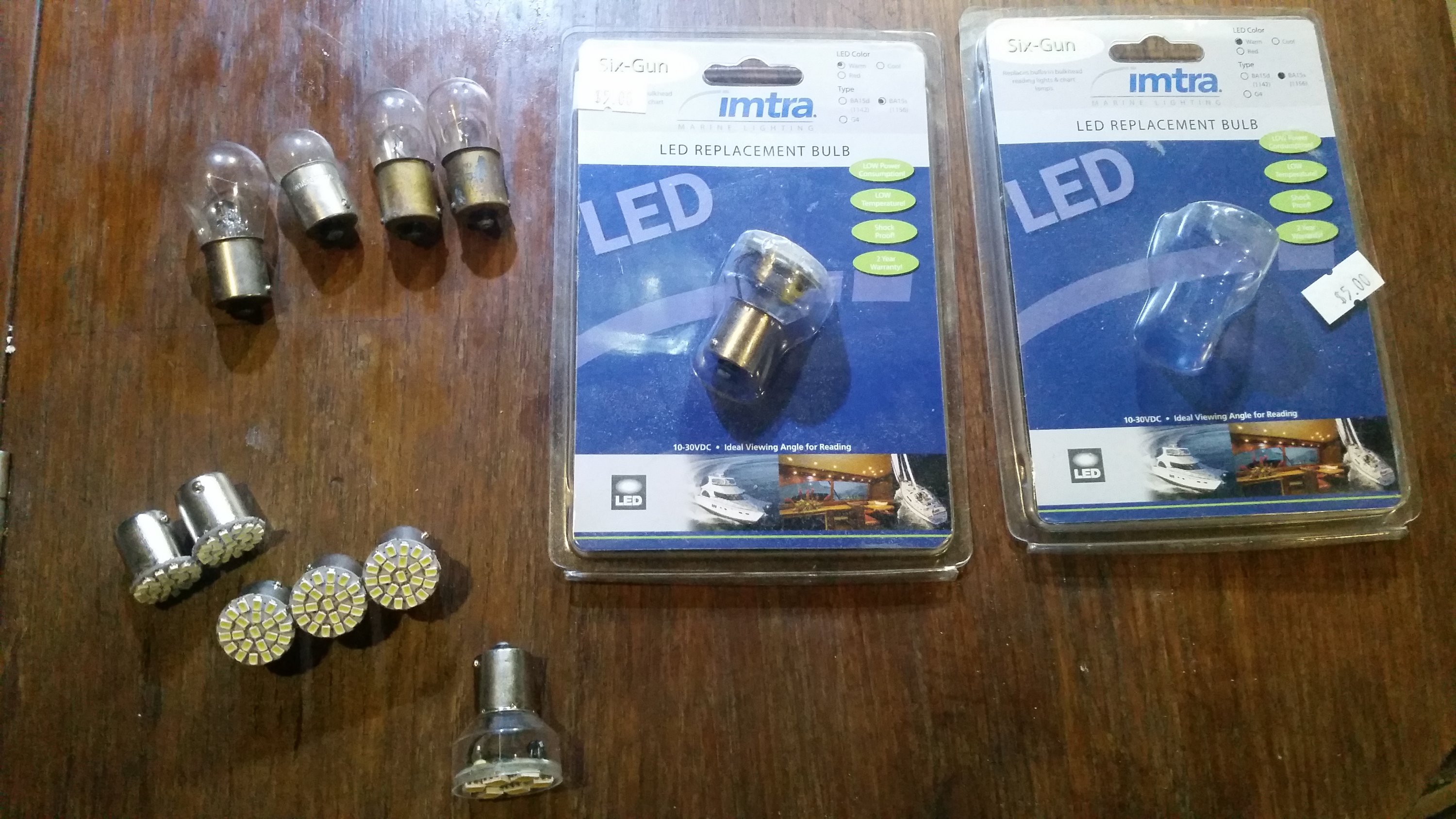

but I have these directional reading lights above the lee berth and dinette in the salon. They are BA15S bases, but the reflector is part of the socket, so the socket is slightly deeper than normal, and stays narrow beyond where the bulb base would go for a short distance. 1/8' max.
This was enough to cause the Imtra bulbs I bought at the Pompano Beach marine flea market to not seat fully. I bought a bunch of cheap BA15S bulbs off ebay, and was disappointed when the also wouldn't seat fully. However, at $9 for 10 bulbs, I figured I would screw with them to see if I could solve the problem.
I sanded the outside edges of the cheap bulbs, and was able to remove enough of the extra plastic around the edge of the bases to get them to seat. They are a bright white, so I may replace again, but satisfied for now.

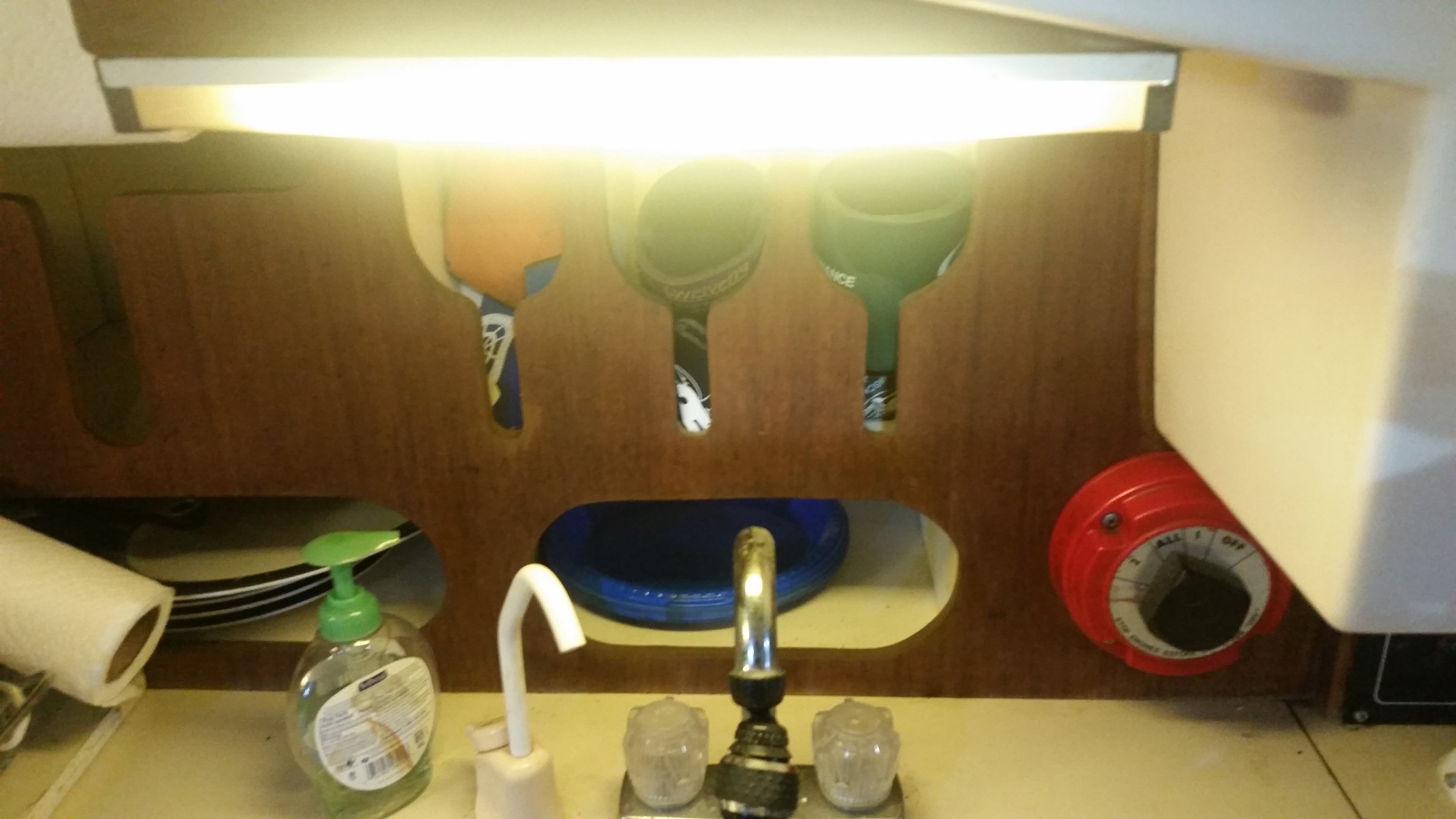

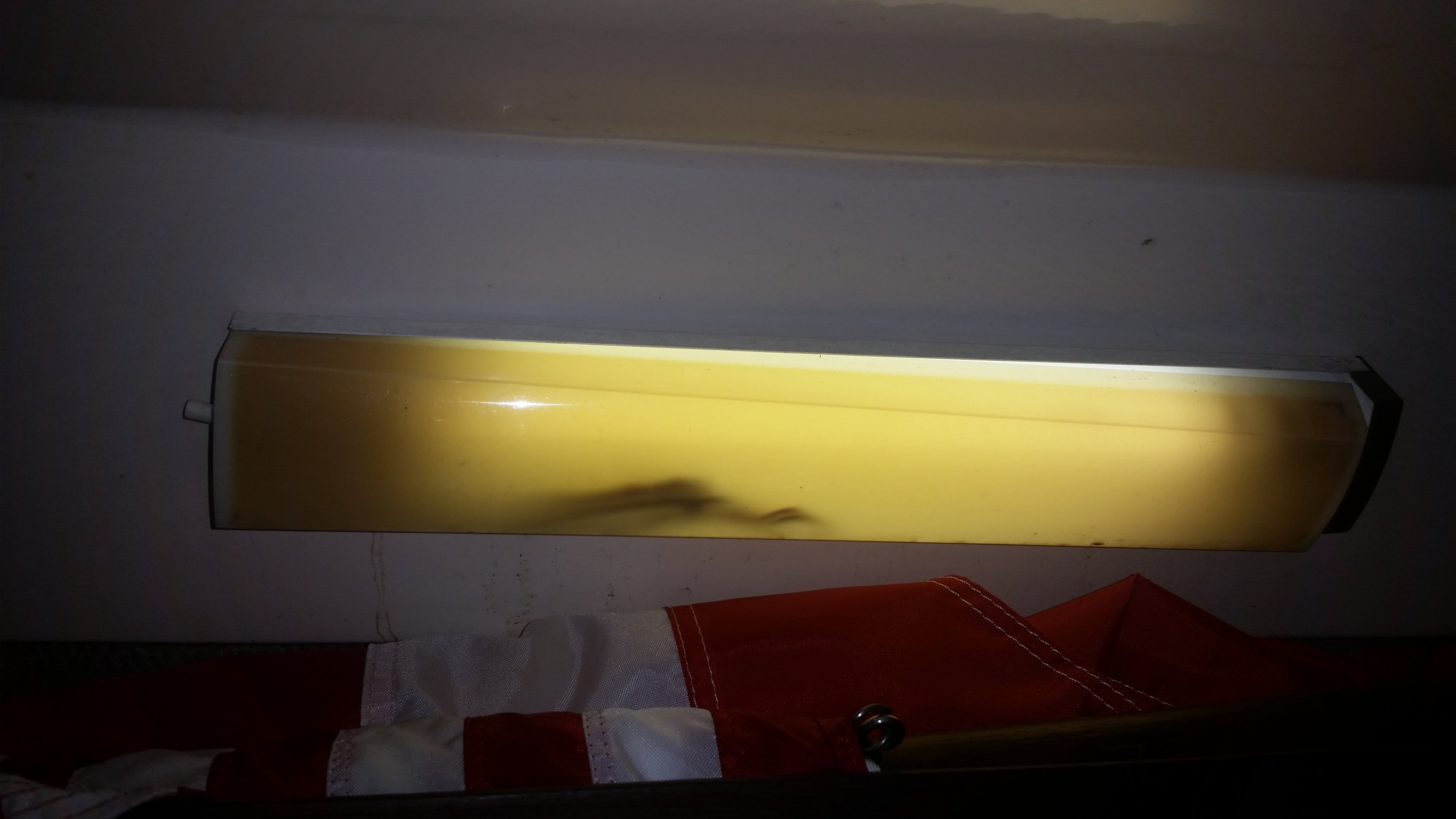

While I was at the boat installing the new LEDs for the reading lights, I took some pictures of the 12" fluorescents in question.

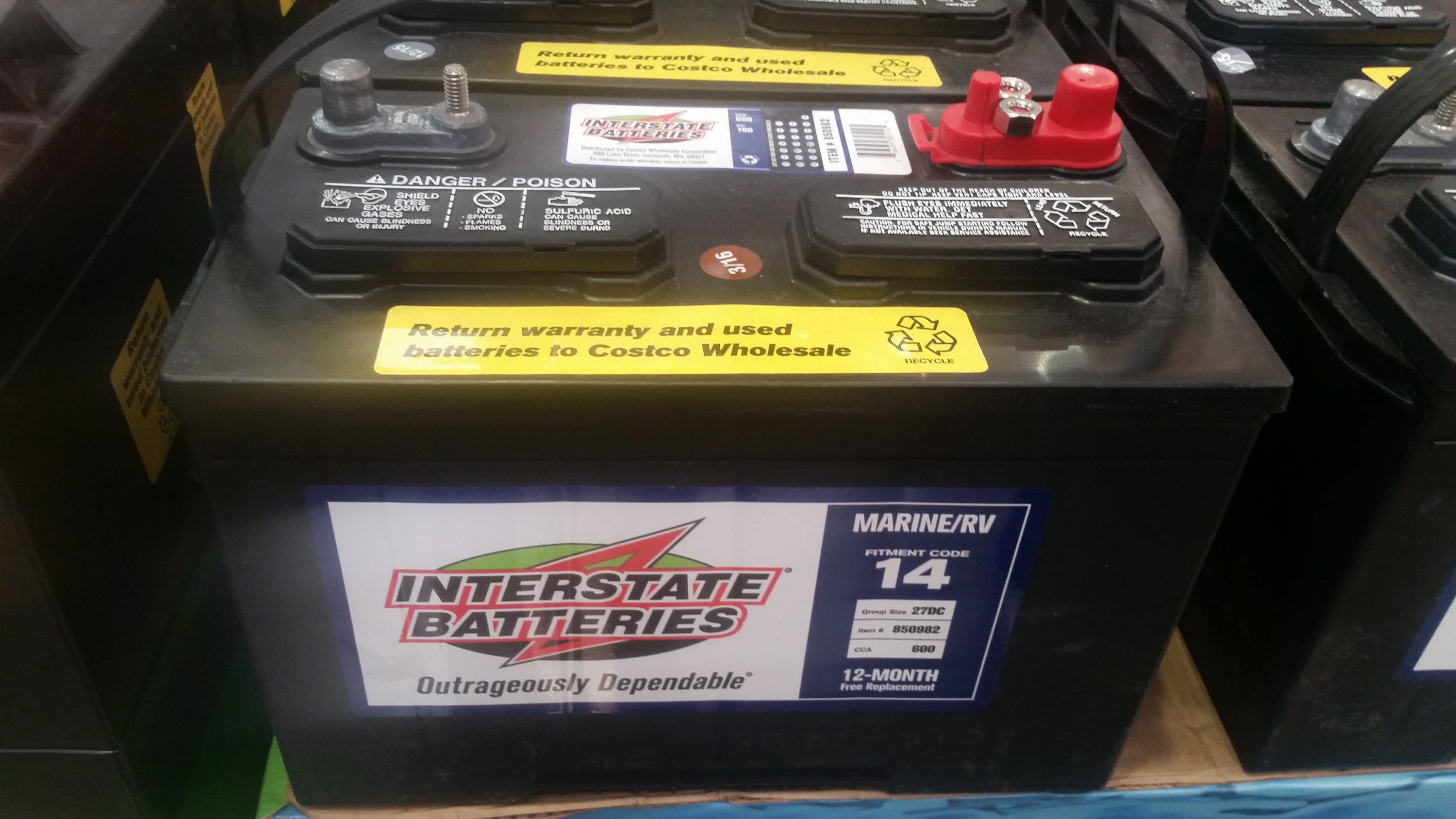

Also I went to Costco during my lunch break today, and these are the batteries they have on sale here.
The 27DC is $78.99, and the 24DC is $72.99.
They weigh a lot more than a standard car battery of the same size. I checked. Do you think they are what they say they are?
