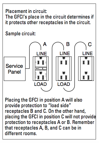

That's an interesting analogy, but not literally (electrically) correct. But useful. If you install a GFCI receptacle as the first outlet in a branch it can protect the entire branch. The GFCI outlet has two pair of terminals in addition to the green-wire grounding terminal: line and load. The line terminals are connected to the white and black wires coming from the panel; the load terminals power downstream outlets.
(Just replying in case there's any confusion on this.)
