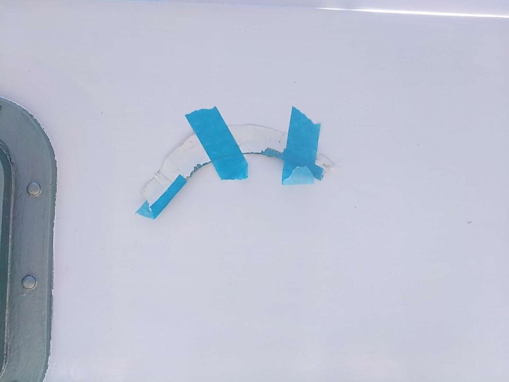

- Every so often and in just a few small sections, the 2-part polyurethane would simply peel away from the now tan epoxy primer. Particularly if lightly impacted with something dropped.
2018

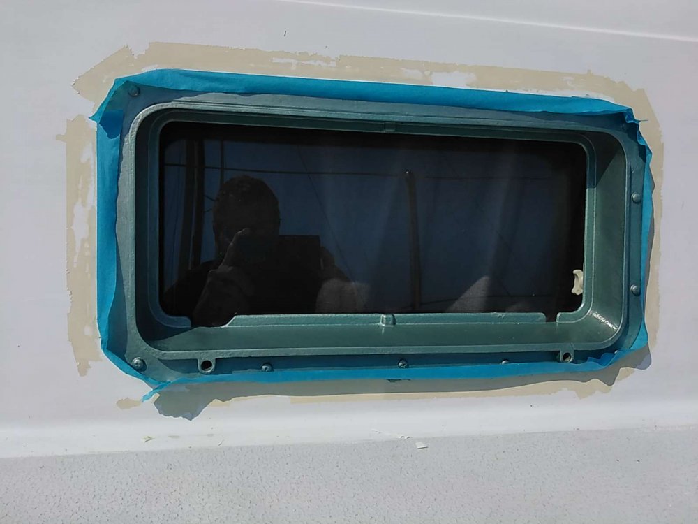

- Had been since 2013 that I painted my port surrounds. Were looking a bit tired.
- On a recent the afternoon, applied blue 3-M masking tape over the cabin top 2-part polyurethane.
- Painted the surrounds the next morning.
- Removed the masking tape right after.

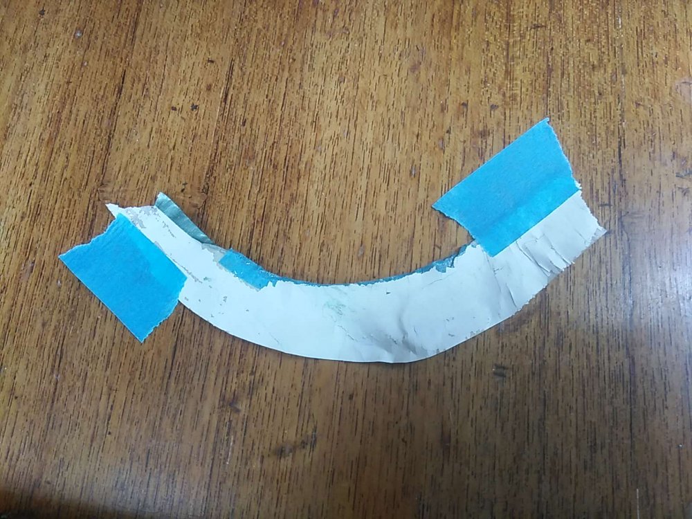

- Look at the attached photo! The 2-part has almost totally separated from the underlying primer!
- The once white epoxy primer is totally yellow/tan. And I can even put a gouge in it with a fingernail. No longer rock hard!
My solution going forward: Old boat. Plus less finicky and getting older owner. Don't want to deal with grinding/sanding down the surface to remove everything. (Which in California anyway shouldn't be done at the berth due to water contamination concerns.) I will simply whimp-out and dab on white 1-part polyurethane wherever paint separation happens.

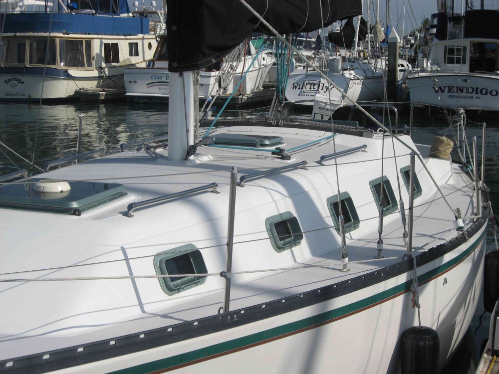

The other photo is the appearance of my deck and cabin top during happier days gone by.
