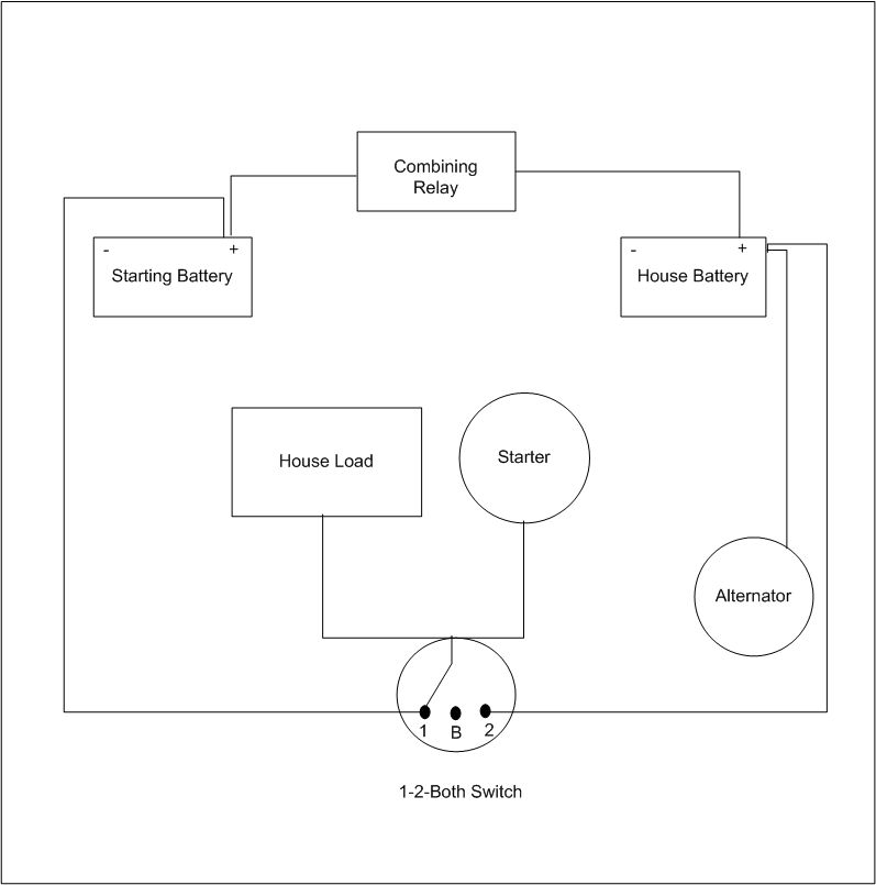

Here's a basic wiring diagram. If you don't have a combiner, use the B on the switch.

We can only guess at the reason the PO did the wiring. Electrical systems on boats follow a similar design. A charging source (in your case the alternator), is connected through a switch (or in the diagram by @Stu Jackson a combining relay and a switch) to the positives on both batteries (in parallel). This lets the alternator charge the batteries while generating power from the auxiliary.
Many 40 year old boats have had the electrical systems modified by owners. Some have been improved, others not so much. Rather than spending much time worrying about the way things were done in the 80's I would suggest you gather an understanding of today's system design and work towards upgrading your boats systems. You'll have a better system than designed in the 80's, you'll have access to modern parts, and you will get back on the water sailing sooner rather than later.
