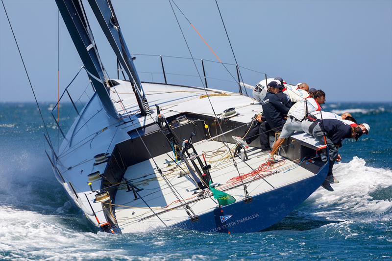

Besides deep high-aspect keels, one of the things that make modern boats like the TP52s so weatherly is the tight sheeting angle. With non-overlapping rigs, the sheeting angle is no longer the limitation of windward angle. And this is cracked off a bit!

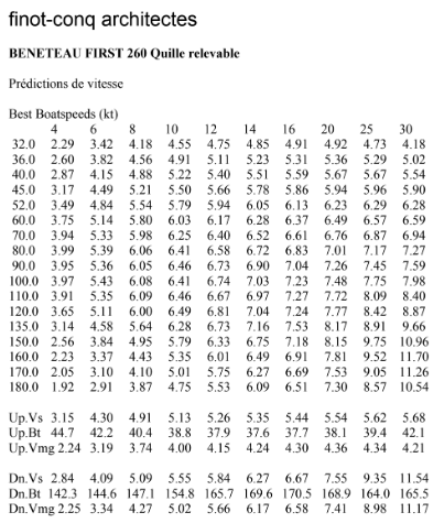

Finot produced a decent set of polars for the First260, they do that for all the First boats they design for Beneteau. But sadly it omits slip. So we have to figure it out on our own.
Looking at Up.Bt (upwind angle) you can see we have two modes, below 8 knots TWS, and above. Below we have to foot to keep the boat moving and flow attached to the narrow keel. Headsail is eased the the lifelines, and we tack tru almost 100 degrees.
Above 8 knots, the keel works, trim on, and the boat takes off - the narrow sheeting angle product some crazy upwind angles. 37 degrees! I sight down the traveler, and when I see the mark we can safely go.
Our RaceGeek D10 will display both course and heading, the difference is slip. In slack water thats leeway. I'm trying to get the team at racegeek to make that delta an optional display!
