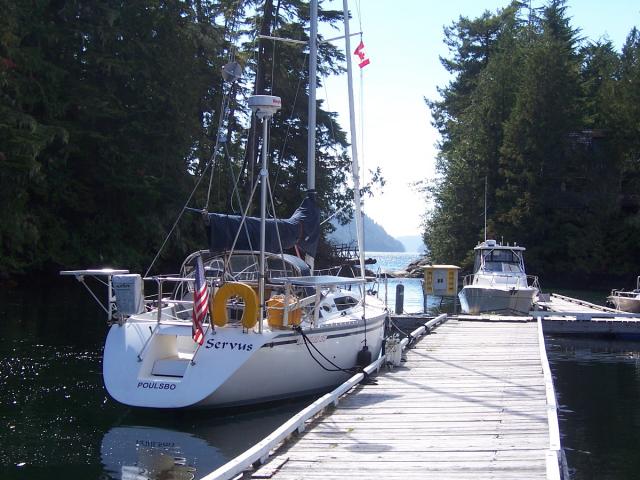

What about adding solar panels?
If you're on the boat a couple panels would help to counteract the usage so the charger wouldn't have to work so long when you returned.
Last winter a garage with a couple antique cars in it near us burned down. Cause: a battery charger.
Picture: Couple Kyocera 130s. Could go with smaller or just one for starters. I'm using a Blue Sky controller.
