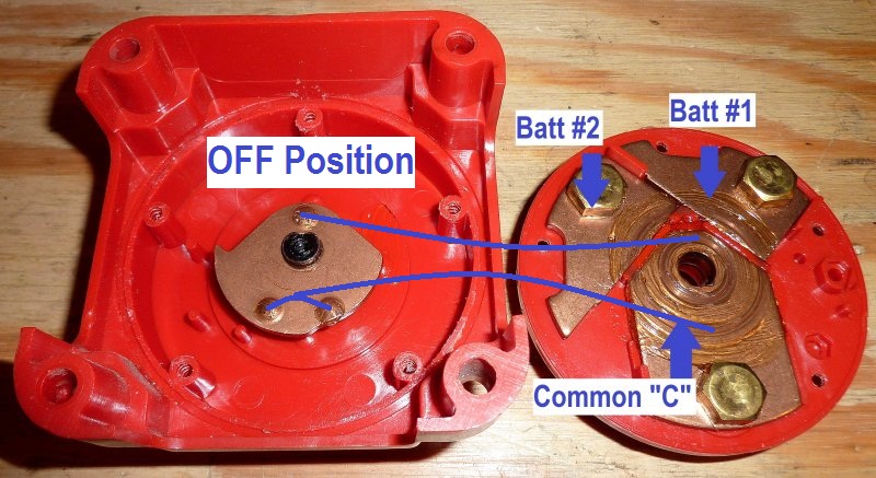

I work on boats for a living, as a marine electrician, and have never once seen a physically melted US type battery switch, (European Beneteau/Jenneau, Hanse type switches I do see melted and failed) that was properly rated for the use. Even then I see piles and piles of switches that were undersized for the use (usually on power boats) and they still survive..
This one came off a commercial lobsterboat. It started a very large 3208 Caterpillar diesel and ran massive pumps, and equipment, for nearly 25 years. It was only removed during a re-wire and the proper HD switch was installed. I though for sure this one would be my golden ticket to Ample's "melted switch phenomenon" but it was not. Despite this boat ideally needing a "heavy duty" battery switch this standard grade switch was in fine health even after 25 years......
I have opened up a number of switches to autopsy them and found even 35 year old switches in fine health. For sailboats finding a melted one has proven to be the proverbial needle in the haystack..

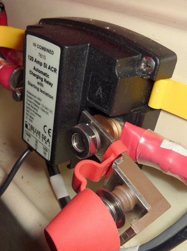

The Blue Sea 120SI is one of if not my favorite combiner for an application like yours. The Yandina's are well backed but I use mostly the 120SI on an install like yours. I have broken a couple cases on the Yandina's, and they always send another without issue, but it takes time to tear them down to replace the case.
The Blue Sea ACR's are extremely well built and over engineered and don't mandate what size and length wires you must use, Yandina does. With the 120SI if you use jumpers capable of the batt fuse ratings then no need to buy extra fuses. I have never seen or heard of 120SI fail except for lightning damage. IMHO, and from many direct conversations with Blue Sea's head of engineering, I know their stuff is put through the testing ringer like no other company in the marine market place.
I know nothing about the Charles and like many of their products I suspect it was out sourced as a filler product to their IT's and battery chargers? Could be in-house but I feel like I have seen it somewhere before..
Blue Sea has designed their product in-house, built it specifically for the marine environment and thoroughly tested it. It is completely sealed. They also stand behind their products at the top level in the industry. I am not a fan of the Cyrix or the BEP product when compared to the BS ACR...
That said the Echo charger is literally bullet proof and very easy to install but don't expect much in the way of support. I only know of one failed Echo Charger and it appeared to have been dropped. You always have the BOTH position if you need more current.
For your situation you really don't "need" any of these devices but they do make it seamless, remove a lot of HEF and are an extremely reliable class of product..

The 5 minute rating on the ACR Mini is higher than 65A and 65A is the continuous rating. Personally I would not do that, especially for the $18.00 difference, but you'd probably be fine. If you ever depleted that other battery using BOTH would be better than pushing all that current through the ACR.. The 120SI also has SUBSTANTIAL lugs and ample room to wire it.
For example with a thick COPPER washer between the MRBF and the main batt cable lug I can add an ACR to a battery compartment that lacks the height for a MRBF fuse and mount the fuse to the ACR 120SI stud. There are very few combiners that you can do this with. Most have dinky little studs and barely room for the parallel wiring. The 120SI makes it easy. The S-34 MKI is one of those boats that lacks height for an MRBF but that does have room for an ACR...
A short 7" jumper to the house POS from the MRBF and the install is done. The other bank also gets a fuse...
