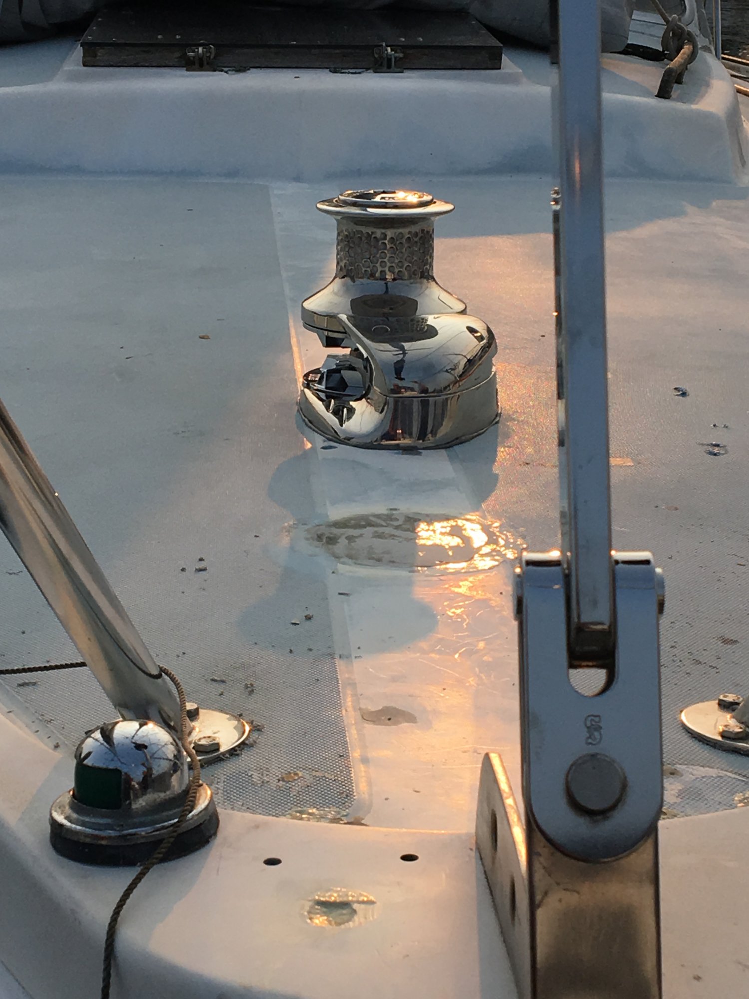

Going to cost $2500 to $3000 IF you do it yourself. Approximately $2000 for the windlass, circuit breaker, control switch, drum, & gypsy, $500 for 1/0 copper cable and misc. connectors. Add to that chain, shackles, & rode and a method of mounting the windlass to your boat.
Definitely not an inexpensive or easy project; did mine 9 years ago installing a Lewmar V2 vertical windlass.

$500 for 1/0 copper cable and misc......did mine 9 years ago installing a Lewmar V2 vertical windlass.
9 years ago...That was before Copper went through the roof. I did my Lewmar V3 in 2018. If I remember correctly, in order to get the desired voltage (with 3% or less drop) the 20ft from the batteries to the windlass and put the proper connectors on the cables, the cost for the copper wire was almost as much as the cost of the windlass. :yikes:
It was a great project and serves me well. :biggrin:
I removed the manual windlass, which found a home as a storage weight in my garage. One day I'll find someone who wants a manual windlass. Someone young and full of the energy it takes to pump the windlass and wind up the rode/chain and anchor from 30ft.
