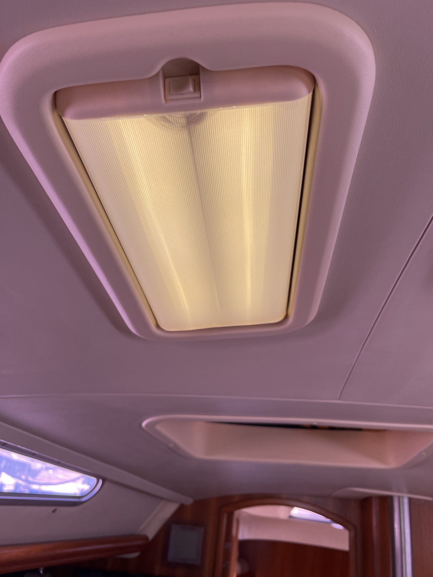

Hi. We have a Hunter 41DS and are interested to see if anyone out there has upgraded the interior cabin lighting and if so what have they done. The 4 salon roof lights look like cfl light bulbs and they're not very bright. Not even sure how many amps they draw as they're not as efficient as led. I'm going to look at removing a light and see what kind of led system I can put in place and make it look good. Thoughts/suggestions welcome.

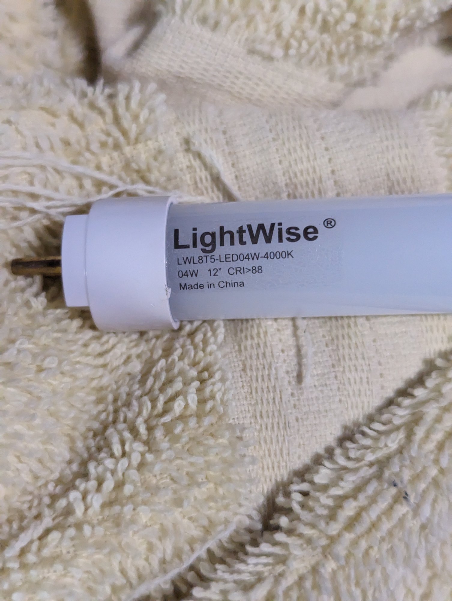

I have an 05 Hunter 41DS and these bulbs were a drop in replacement with no extra work or extra wiring. They have been working great for the last couple of years.

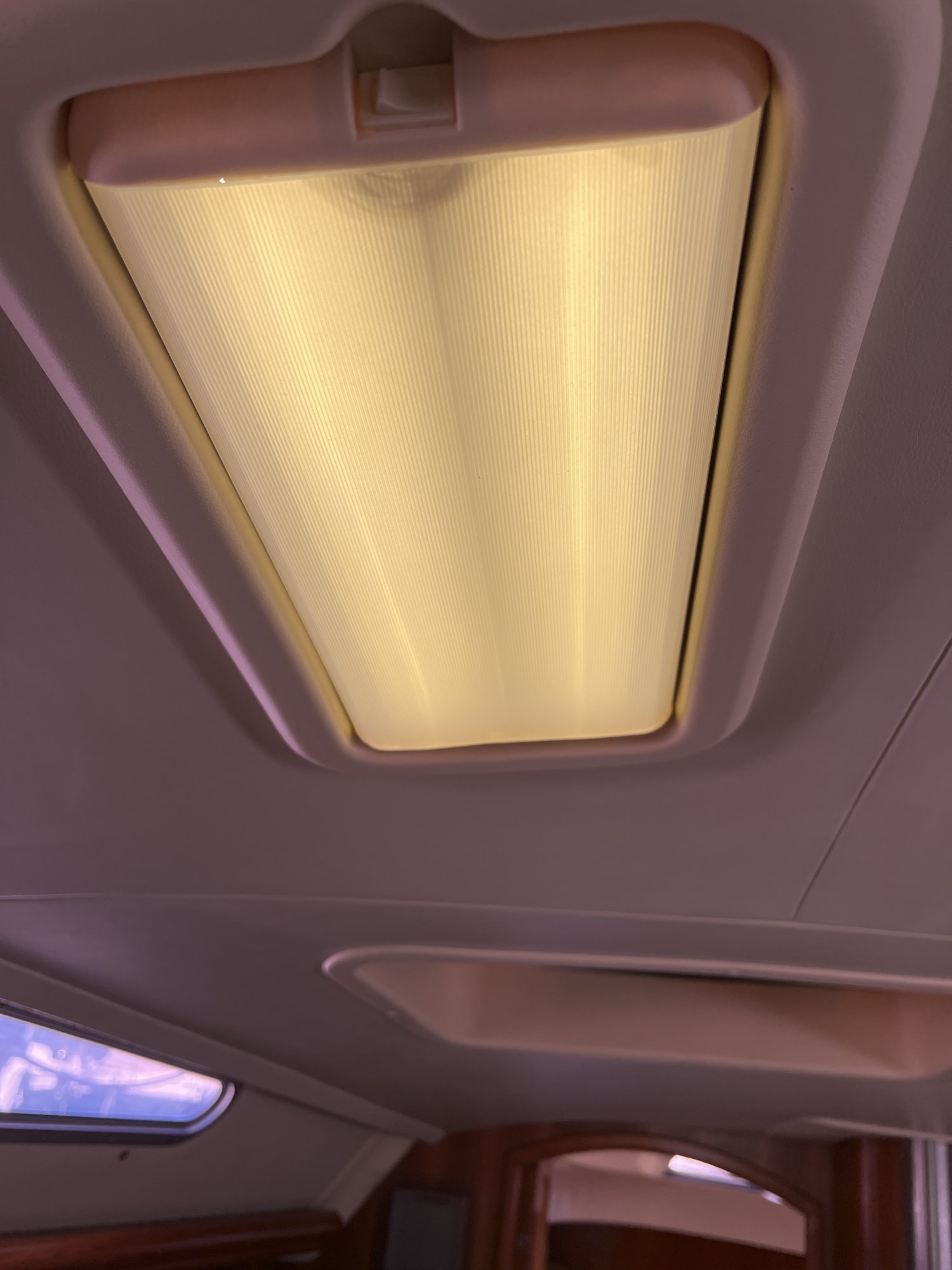

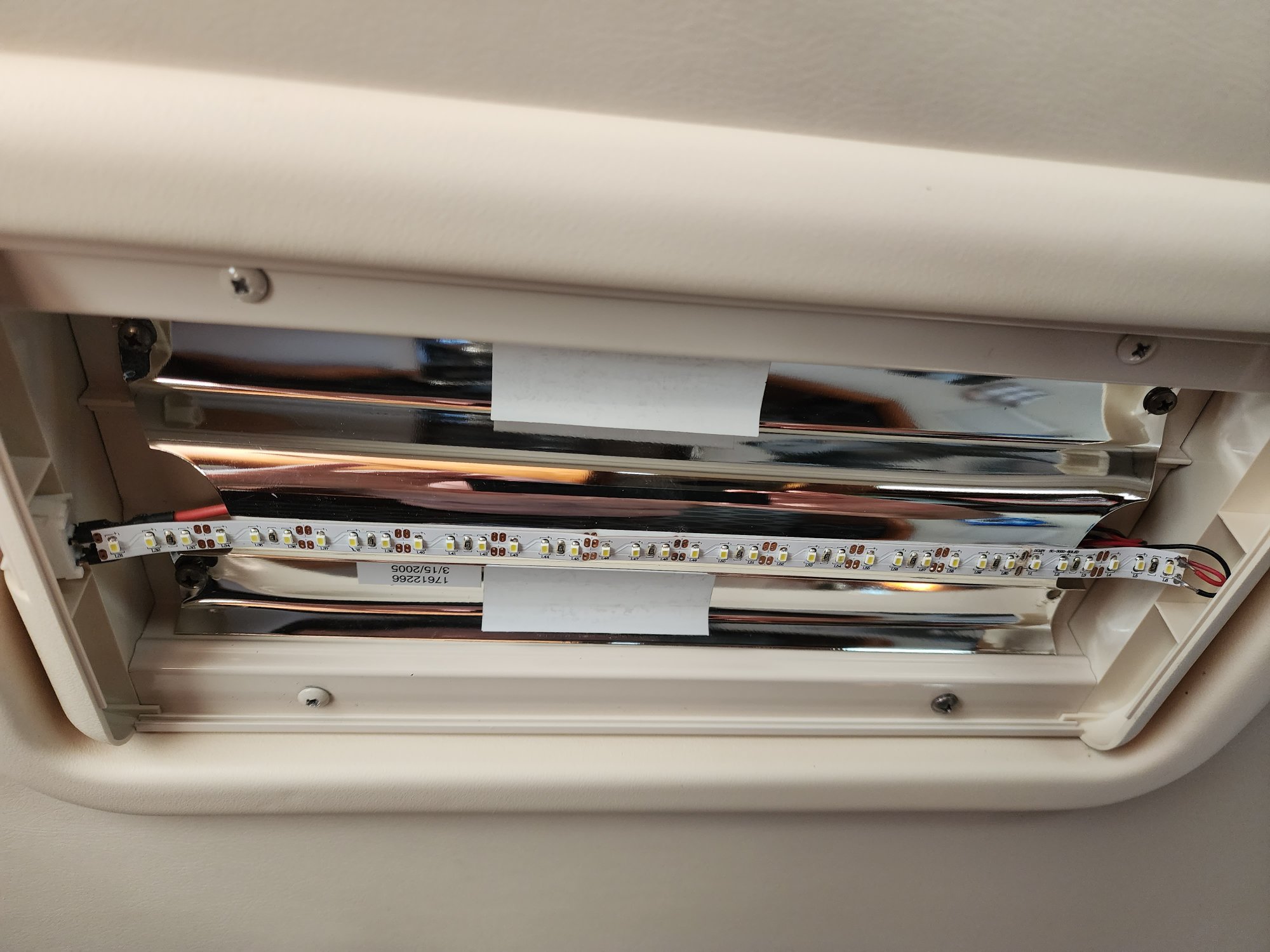

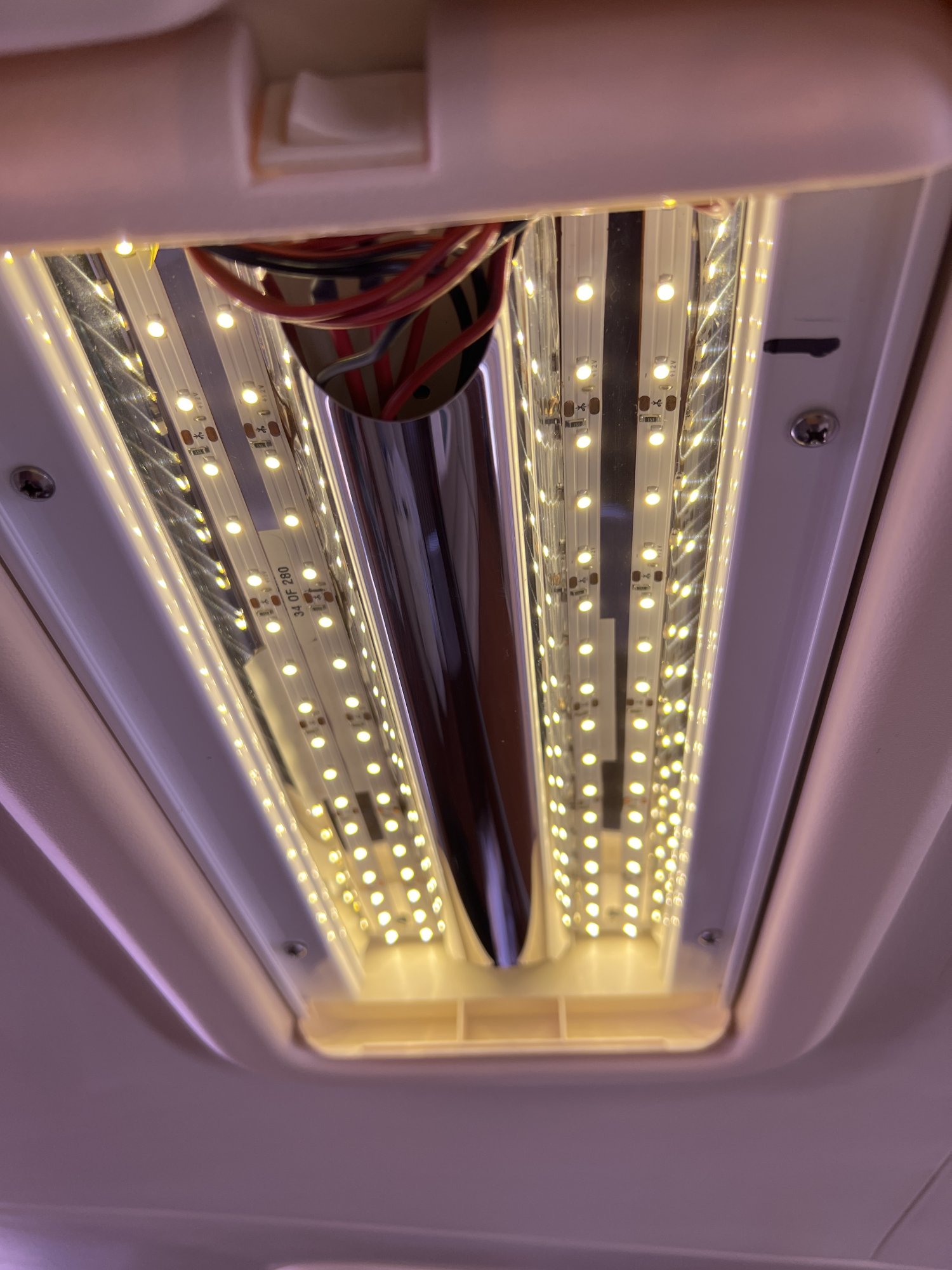

Thanks both for the info. I took off a lens cover and found they've already been converted to LED already (see pic). Now I need to decide if I want brighter led or accept them as they are. When all on they draw about 1 amp only total so that's a huge bonus. Thanks again

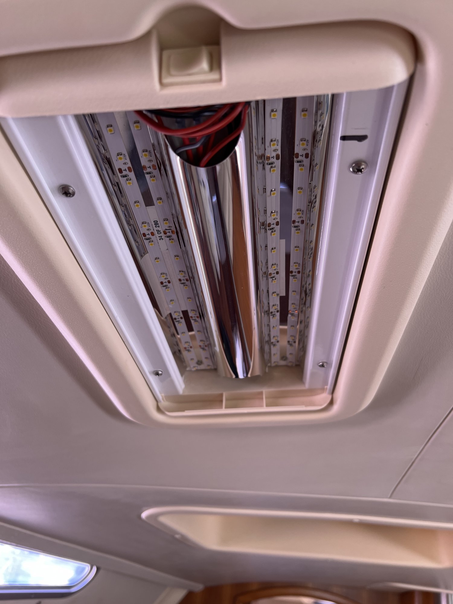

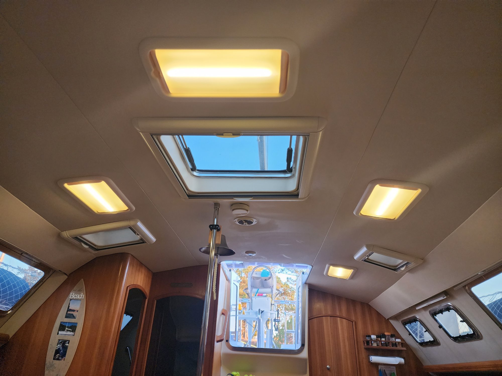

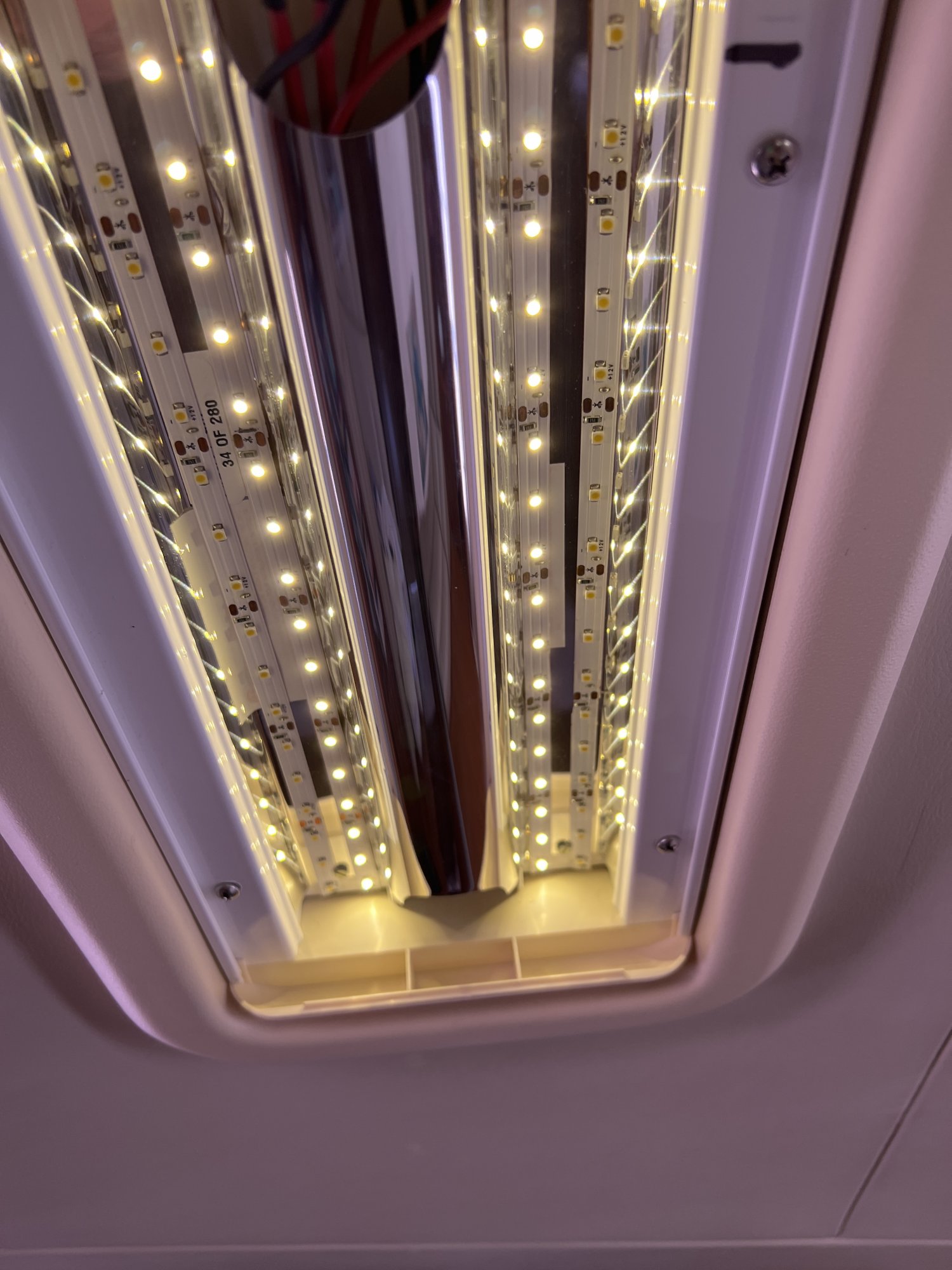

A big part of the unsufficient light output is that the PO installed only one Led strip to replace 2 fluorescent tubes. Added to that is the position of the Led strip, it is installed in the middle of the 2 reflectors causing the reflectors to be useless. Put in 2x2 Led strips inside the reflector and use the ceiling installed switch to select 2 or 4 Led strips. See the pictures

I did the same thing as Senang on my H38. It works great and provides a lot better light. I will say that I really didn't get any improved energy efficiency as the original fluorescent is fairly efficient.
