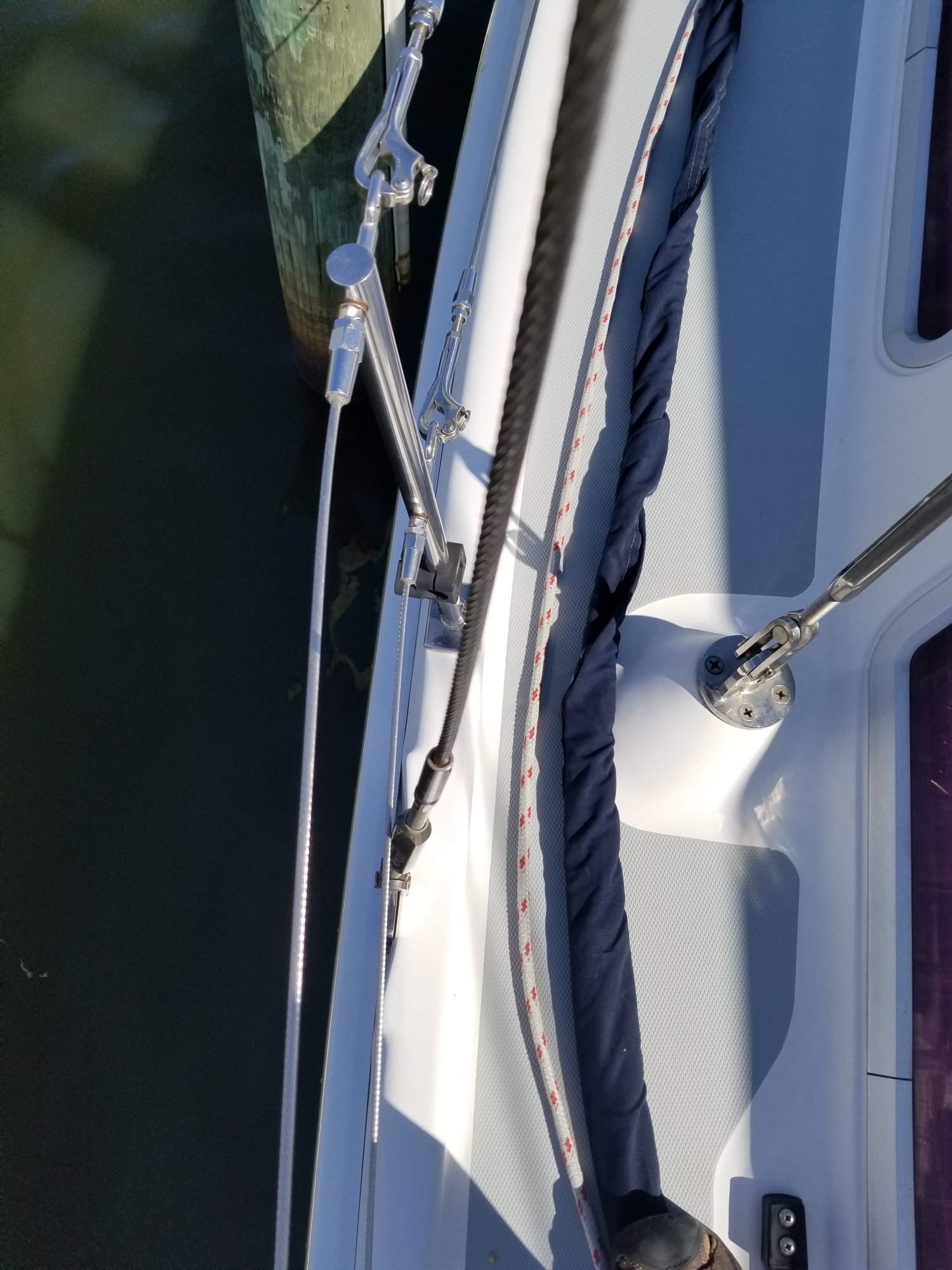

I'm coming from a different experience with traditional Catalina rigging, yet something seems off. The outside shrouds on both sides feel very loose at dock with no sails up. From this pic you can see slack where the cable extends from the turnbuckle. The turnbuckle also seems a little pushed in by the lifeline. Does this seem normal for a Hunter, or should the shrouds definitely be tighter?
23,804
It is an interesting query.
It is not just Hunter'e but all boats should not have the lifelines contacting the shrouds. I would look at the stanchion that is out of the image on the bottom. It is possible that the stanchion has been pushed inward causing the lifeline issue.
WIth regard to the tension on the shroud. This is a separate issue. Typical for shrouds, the tension is set at 15% of the tensile strength of the wire. Your hunter manual should have the technical shroud tension values listed. These values assume that the shrouds are OEM. If the standing rigging has been changed by a Previous Owner then all bets are off.

Ok, for now I'll consider the positioning of lifelines a separate issue. A sister h36 docked near me has lifelines similarly touching the rig. I am asking from a non technical perspective before delving deeper. I don't own a Loos gauge and would probably enlist a pro if I'm worried about it. Should I be worried if I can easily wiggle the outside lower shroud from it's original position + / - 2.5" toward and away from centerline of boat at around 5 feet above the deck? Note in the pic the angle between the turnbuckle and shroud cable. Should they form a straight line and the lower outer shroud be pretty tight and firm at dock without sails up?

When properly tensioned those shrouds should not be loose. Purchasing a Loos gauge to check the tension on your rigging is a worthwhile investment. Heck, offer to split it with the other H36 owner and its really affordable, and would see more use. You'll spend more than the cost of the gauge to get a "pro" to come out and spend some time going over your rig tension. But I do recommend a rigger as well to start here, since the rigging looks to be completely out of tune. Here's the Selden manual that may be of help: 595-540-E.pdf (seldenmast.com)
23,804
It would be "TOO LOOSE" for any of the boats I have sailed on.
If I was sailing on a Hunter with the condition you describe, I would consider a rig inspection.
Why is the rig sloppy?
  • Perhaps just a tune up.
  • Perhaps something is happening with the spreaders.
  • Perhaps something is happening with the chainplates
Those are the usual suspects when rigging on a boat becomes sloppy. There are other issues, but no need to explore them all at once.

Way too loose!
The diagonals adjust prebend in the mast, mast needs to be down to adjust these properly, the inners and outers are quite easy. Loosen the inner and cap stays, ensure mast is in column by hanging a bucket full of water on the spinnaker halyard, swing the bucket to the port side and lower to the rub rail and measure now repeat on the starboard side, adjust cap stays until the mast is in column then tighten the cap stays evenly keeping the mast in column, keep tightening until the shrouds are at 15% of breaking strength (approximately 1,800# force for 3/8 7x19 cable), then tighten the inners to 15%, badda bing you are done.
You will notice the when tightening the cap stays the mast will bend to aft, once the inners are tightened the mast will return to what ever the prebend was set to before the mast was stepped.
Buy a loos gauge they are not that much $$ and you can use it in the spring when you restep the mast.
Now if the diaganols of the rig are loose then you will most likely need a rigger, although Selden has some great instructions for how to achieve the proper prebend as well.
Rake is purely a function of the length of the forestay, which may or maynot have adjustment, many of the B&R rigs don't have forstay length adjustment other than shortening the cable and reswedging the fitting (our 41 doesn't have a turn buckle on the forestay) ergo no adjustment.

Until the boat is pulled I would take lots of pictures - Particularly of the spar to show Mast rake, pre-bend, and shots up the mast looking for any out of column areas both at the dock and while sailing, measure tensions where you can (Buy the Loos gage), mark the turnbuckles settings etc. And for the rest of the season I would tighten those loose ones to be just a little slack on the lee side in 10 -12 knots.
