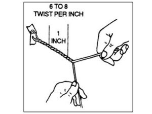

Curiously, I've been moving away from rings and towards wire over time. It seems easier to deal with and failures are less common IMe if done properly.
The only failures relate to tightening them by twisting. Wrong. That will break the wire. Pull snug, 2 wraps if there is room, and then twist 8 turns per inch under modest tension. Do NOT use the twisting process to tension the wire. Its purpose is only to hold the ends from slipping. Trim and tuck the end. This is how it is done on aircraft. 0.040 is plenty, monel if you can find it (more malleable). It will not break if properly installed. Over twisting is what causes the failures. The aircraft guys have literally written the book on safety wiring method. safety wire practice
Thanks for the link. Yeah i find myself moving away from pins and rings as well. Im using wire a bit more now. I found a roll of .050" 316 stainless in my rigging bag, so am using that for now since I have it, but McMaster Carr has some nickel .060. Its $100 per spool though. Will grab a spool next time i order from them.
