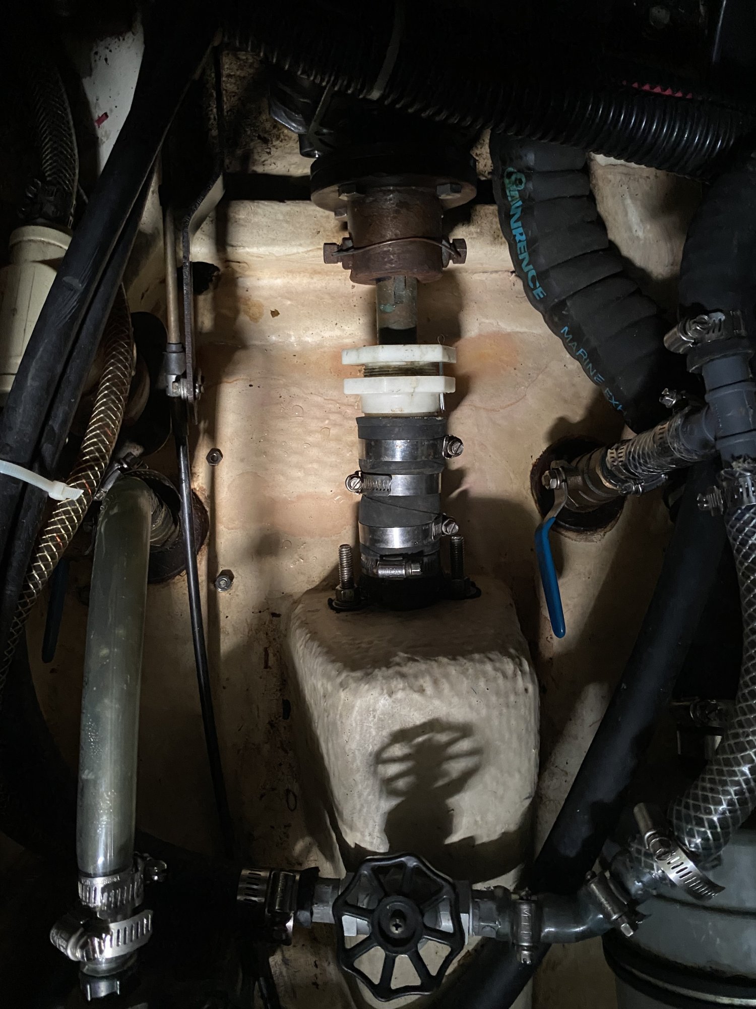

I have a 1990 Hunter Legend 35.5 and have owned it since 2012. I have never replaced the packing in the stuffing box and there doesn't seem to be an issue (there is no leaking when the shaft is not turning and when the shaft is turning there is the required 1-2 drops every minute or so). I still have some threads left on the locking nut where I can tighten it a bit more if required; however, I want to be proactive as apparently the packing should last only 5-7 years and I just found this out.
Every year when the boat first goes in the water, it leaks and then after about 15 minutes it stops as I guess the packing is expanding when the water reaches it. I am really gun-shy in doing this, and have read a lot on the procedure and viewed a lot of videos; however, I can't find my exact setup anywhere. The attached photo shows my stuffing box. As you can see, it has a nylon locking nut and a nylon receptacle. I un-did the locking nut and slid it as far back towards the transmission as possible, which only leaves about 1" clearance to remove the old packing and install new packing. I bought a packing removal tool (attached) and when I used it, it hooked onto a nylon washer that was inside the black tubing. I'm assuming that this is a compression washer which the locking nut uses to evenly compress the packing. I stopped at this point because I'm not sure if the packing rings are immediately behind this washer. As well, I'm concerned about how to get the new packing rings back inside as a screwdriver would not be able to be used to angle it properly to push them back in.
Does anyone have a similar setup and have they replaced the packing rings where you could give me some guidance?

Sound advice and the suggestion of the PVC pipe is very ingenious! My only problem with this method is that I have to push the packing rings about 2-3" into the receptacle and I only have about an inch of exposed prop shaft to place the packing rings onto. All this to mean that I could use the PVC method to push the rings into place, but then I'm faced with the dilemma of how to retrieve it out of the cavity. This method would be perfect if I had access to use a length of PVC which would allow the pushing of the rings into place and still have PVC pipe exposed where I could grab it and pull it out.
I'm on the hard right now and going in the water in a week. My best option right now I think will be to just put it in the water and hope if it is leaking I can stop it with the remaining threads I have on the locking nut. If that fails, then just immediately lift the boat back out, leave it on the hard for the season and use that time to try and replace the rings somehow if I can figure out how to do it, or go as you suggested and change the system over to a dripless one.

When I did mine, I cut the stuffing to size, then slipped it over the prop shaft. I would push it into the proper space with the nut, then add the next piece. Eventually I got all three in and found I still had threads enough to snug up the box.

Zoom767, the length of the hose is 4", I would think you have to push the rings in no more than 1.5". You can place the first ring and push the ring in 1/2" with the plastic pvc pipe, then repeat 2 more times, then press in with the top and screw in as needed.

I am aware of all that you mentioned above; however, although I can properly measure the diameter of the shaft (1”), because of this particular setup I can’t measure the ID diameter of the stuffing box (too far inside that plastic part as the actual ID of the box where the rings rest against it and the shaft are past the threads of the box which is used for the locking nut and the tool will not fit inside). I’m having to trust the comments from AI that for a 1” shaft it is usually 1/4” packing — along with me finding a spare package in the tool box that was bought by the previous owner (which was 1/4”).

Thank you all for the advice. I decided to take a chance and lift the boat in yesterday without doing any work on the stuffing box -- I just put everything back into place as it was. I had about four threads left in the locking nut and hoped that if it was leaking that would be enough to tighten and stop the leak. If not, I would have had them lift me right back out and that would have been it for the season. Funny enough, the damn thing didn't leak a drop when it was put in the water as opposed to last year when it was leaking more than normal then slowly stopped after about 30 minutes.
After I motored to my dock, I tied it up and re-checked. Not a drop of water. I secured the boat for the night and left.
Today when I returned, there was still not a drop that had come out. I thought I would start the motor so I could put it in gear while staying tied up at the dock to see if I could get it to leak the required 1-2 drops every couple of minutes. But, before I did that I just loosened the locking nut 1/4 turn and noted that it was now completely loose - but no water was coming out.
Now, that's an interesting scenario!
I'm going to assume that the thin plastic washer that I had pulled out and found it was between the locking nut and packing rings must have somehow remained in place with no pressure being exerted on it from the locking nut and is holding the pressure on the packing.
So, bottom line, I've re-tightened the locking nut back up which will ensure that I won't sink the boat - but will leave the issue of possibly overheating the shaft when it is turning. I'm going to forfeit this season, only go to one anchorage that is 30 minutes from the marina and tear it apart after lift-out in the Fall.
