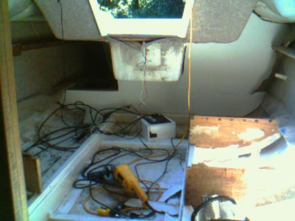

Cabin1050 Bunks removed.  Bunk supports were also removed and replaced. The bunks are glassed to the hull, so I cut them with a jig saw about 2" in, cut the new bunks from the pattern and added the 2", then installed them over the old edge and screwed them in.
Mark Major
