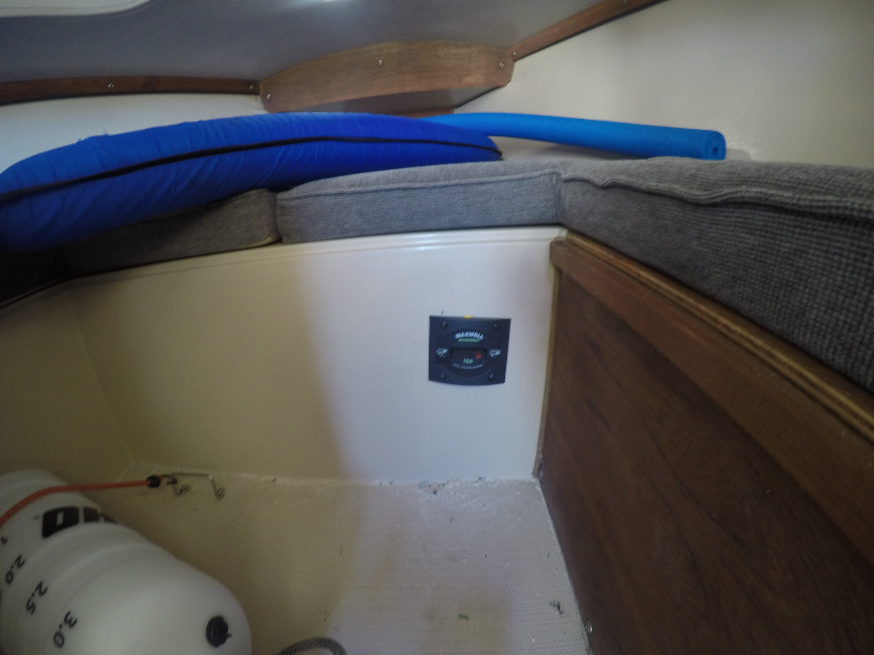

I put the main circuit breaker up here by the v-birth the reason it's here is my two anchors are under here and I wanted ALL the wiring to be as close to the windlass and the batteries as possible had I moved the breaker to the back where the breakers are then I would have had to go larger wiring
