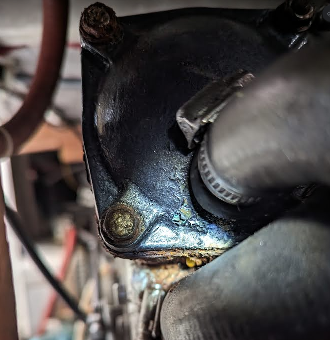

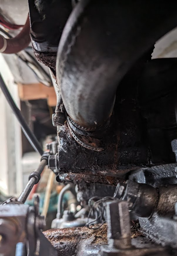

I have a Yanmar 3HM35F and today I planned to change the fresh water. I pulled out about 3/4 of a gallon of the orange coolant. As this was my first time changing the coolant I spent some time looking around and noticed that I had some rust forming on a particular spot on the engine. I had seen this before and planned to address it, but as I was looking at how to get access to refill the coolant I looked closer and it appears that the heat exachanger might be leaking raw water from the forward part of the exchanger. So like all boat projects my 2 hour fresh water change has turned into a larger project.
At this point I believe I will need to take off all hoses(raw and fresh) and then remove the heat exchanger. Once I get it home I should be able to get the cap off and replace the gasket.
Before I dive to far into this and assume I am fixing the problem, does what I am seeing and my remedy seem like the most likely culprit? Do heat exchanger gaskets leak? Or is this going to be an even larger issue? It is hard to get images, but I have attached a couple

Sure looks plausible from what you describe.
If a leak can happen it will. It may be just a hose that has leaked and not a hole in the heat exchanger. Taking off the heat exchanger is a practical approach. I did that with mine. I took it to a radiator shop to get cleaned (boiled out), and then pressure tested. I also provided them a zinc anode to install. When I looked inside I found that the anode was gone. You will want to have new gaskets for the ends so that they can put the heat exchanger back together for pressure testing.
Cost me $65 and took 6 days to get in to their work schedule.
I got my zinc from BoatZincs.com (978-841-9978) - America's Superstore for Marine Anodes. But I suspect Fisheries and Harbor Marine will have them.

Good news! Got the heat exchanger off today!
I think I will be replacing the fuel line that goes from the yanmar fuel filter to what I think is the high pressure pump as the one I have on there is a solid line and rusted.
Pretty sure the previous owner had this on the to do list as I appear to have all parts necessary to move forward with the exception of the exhaust gasket. I even have a brand new radiator cap and brand new raw water and coolant hoses to install!
Any suggestions for a radiator and hydraulic shop around Everett? Next up will be to assess the rust situation and get it painted again.
