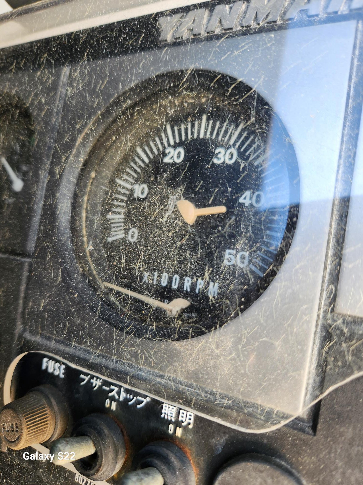

Yesterday I noticed the needle on my tach was broken. The tach works fine and the Yanmar runs great. Just hard to tell accurate RPM.
Does anyone know of a fix for this, where to get parts and if the tach can even be opened and the needle replaces if I can source one? Any tips, or sources would be appreciated. If I have to replace the Tach is there a replacement other than the Yanmar tach.

Glue a toothpick to the stem of the tachometer.
Barring that, purchase a VDO tach. Here is the one I installed a few years back. It accepts all inputs. See the installation guide. If you have an optical tach ($15-$20) as it provides the easiest install.
Lastly, install a Sunbrella cover over your instrument panel and save your next tach and maybe a few other instruments before they disintegrate from the UV.
  • Helpful
Likes: LloydB
10,132
The tach can be repaired, but it is a fiddly, tedious job that requires a lot of attention to detail. The instrument can be removed from its case and then the face is accessible.. carefully remove the back part of the needle then use something like 5200 to repair it. You may have to wrap a piece of thread around the needle base to keep it together. .. Probably not worth the investment in time compared to Ralph's suggestion. The problem is that the needle has become very brittle from UV and cracked from the stress of the push-fit onto the shaft.. A new one is the best fix..

Thanks @Ralph Johnstone - do you have the model number of the gauge you installed? I don't see it on the document you sent. Does it fit nicely into the existing opening.
Thanks @kloudie1 I wasn't sure if the face could be removed from the gauge but the price on the vdo gauge is not too bad.
By the way. I always keep my binnacle covered with a sunbrella cover when I'm not sailing and have done so since 2012. I am not sure what the PO did but the cover came with the boat.
