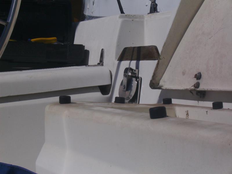

I have received the rubber bumpers, item 9540K25, and am pleased with the match to the existing bumpers. I look forward to a tedious install. :neutral:

Well, yesterday I got good motor oil in the transmission, easily installed the cockpit seat bumpers, figured out why the water drains to the cabin from the slider, put a bungee along the boom to hold the mnsl folded, decided how to fix the detiorated wood area in the cabin sole, and a couple other miscellaneous items. It was a good day.

...."motor oil in the transmission"......That doesn't sound right?? And what are cockpit seat bumpers?
Dec 14, 2003
1,403
Hunter 34 Lake of Two Mountains, QC, Can
Robert, Splax has a Yanmar 3GM30F with a Kanzaki KM3-A tranny. Yanmar recommends 30 weigth motor oil for that tranny. You'll find a discussion on that on the first or second page of this thread. The cockpit seat bumpers are those rubber bushings under the cockpit seat preventing FB to FB contact. On the 34 the seats are on hinges and lift up to reveal lockers. Have a nice day !

Okay??....... Cockpit seat lids or more correctly .... Cockpit lazzerette hatches .... With rubber contact pads instead of rubber caskets. For some water proofing to help prevent water from splashing up under lazzerette hatch and getting below into locker.
