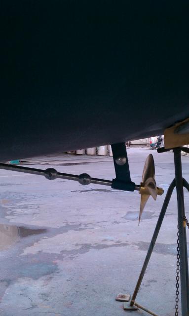

Kinda like this, Les.. Try to stay close to the strut with the weight (away from the middle of the shaft) so ya don't create excess vibes. (by shifting the shaft first critical speed to a lower frequency.)

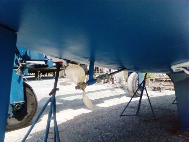

Please note 3 zincs - 2 on shaft and 1 on the shaft support. This can be done in the water but may be difficult to "hammer" it closed unless the diver is really good.
