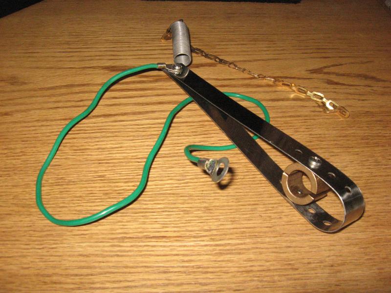

The hanging zinc must be electrically connected by wire to the whatever it is on the boat that you want protected. Hanging only from a dacron, or nylon, or poly line dock-line won't do it. Generally, the hanging zinc should be electrically wired to the engine block, which in turn is connected to the shaft and the prop, and also to which every other bonded thing on the boat ultimately has electrical connectivity to (i.e. that's the motor block). This is why people clip the fish wire to the standing rigging or the pulpits because usually these have electrical contact with the engine block. That said, the electrical connection for a fish even to the engine may not be as good for prop protection as is a shaft collar zinc or a prop nut zinc. This is because I have read that the thin coating of gear oil can disrupt full flow of electrons between the shaft and the engine. Also the mating flange interface between the propeller shaft and the shaft exiting the transmission can rust, further limiting the electron flow to the prop. The work-around is a shaft brush which maintains constant electrical contact on the shaft inside the boat. The shaft brush is bonded to the engine and then the fish wire is connected to the same spot. So now you have an electrical connection of the fish to the prop/shaft by both the shaft brush and through the transmission gears. A pic of a shaft brush is below. I've done this to my boat.
