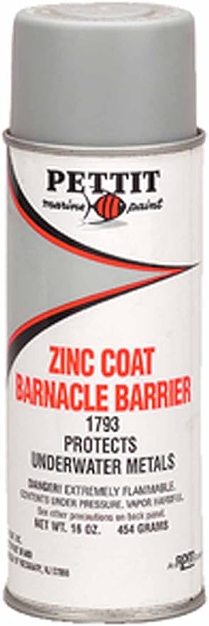

I was thinking of trying this: Pettit Zinc Coat Barnacle Barrier.
