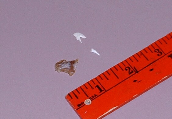

My bilge pump stopped pumping on the last day of the season - Jabsco Model 37202 diaphragm pump 4.5 GPM. When we took it apart today, we found these small particles in the rubber valves, preventing a seal. Cleaned them out and the pump worked like new. My 2 yr old C320 did not come with a strainer on the bilge pump inlet hose, and I didn't even think about it since the boat was delivered with a sparkling clean bilge (Helliers did a really good clean-up on delivery). I guess I was lucky to get by this long without a problem. A warning to others.
