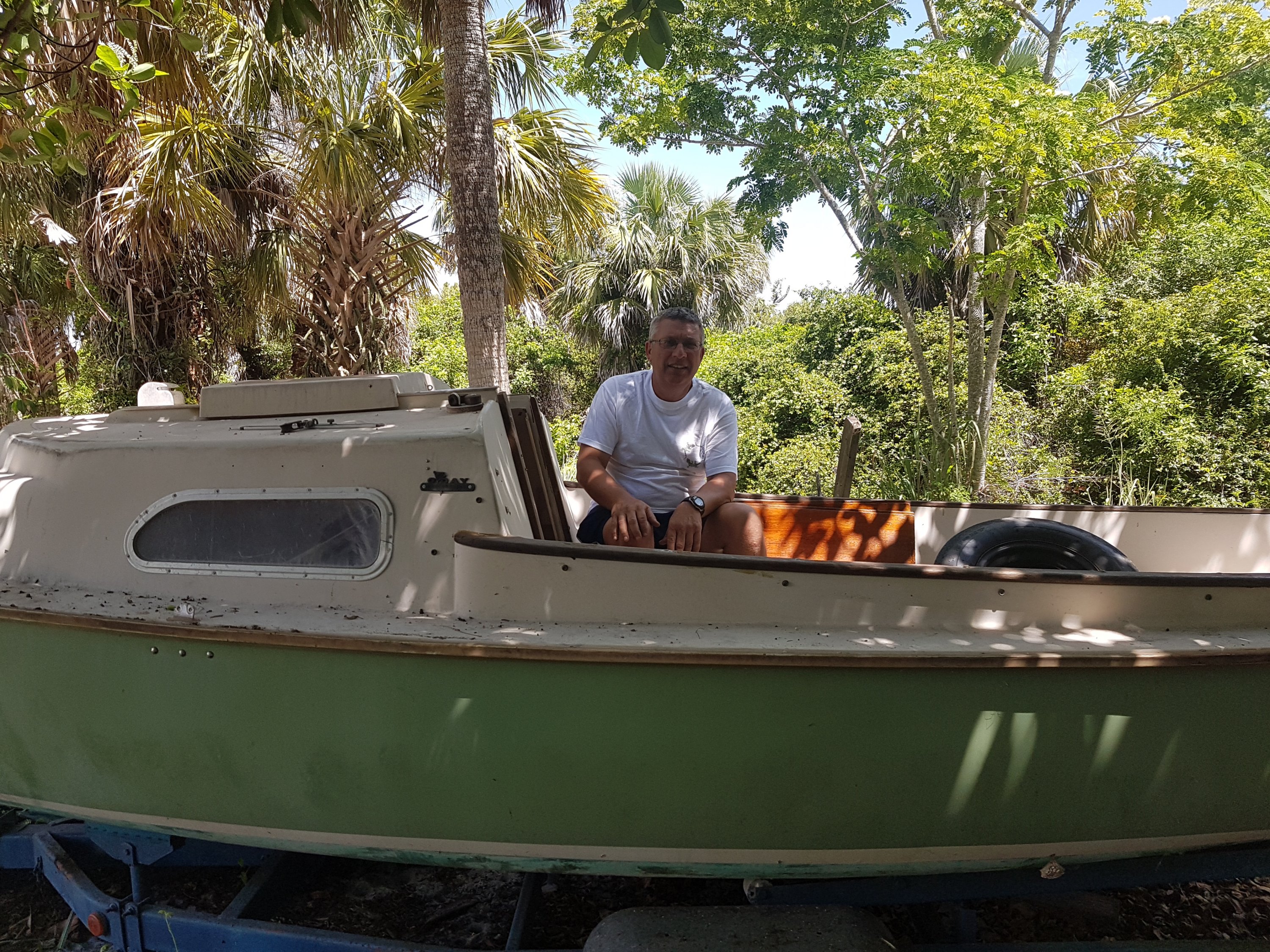

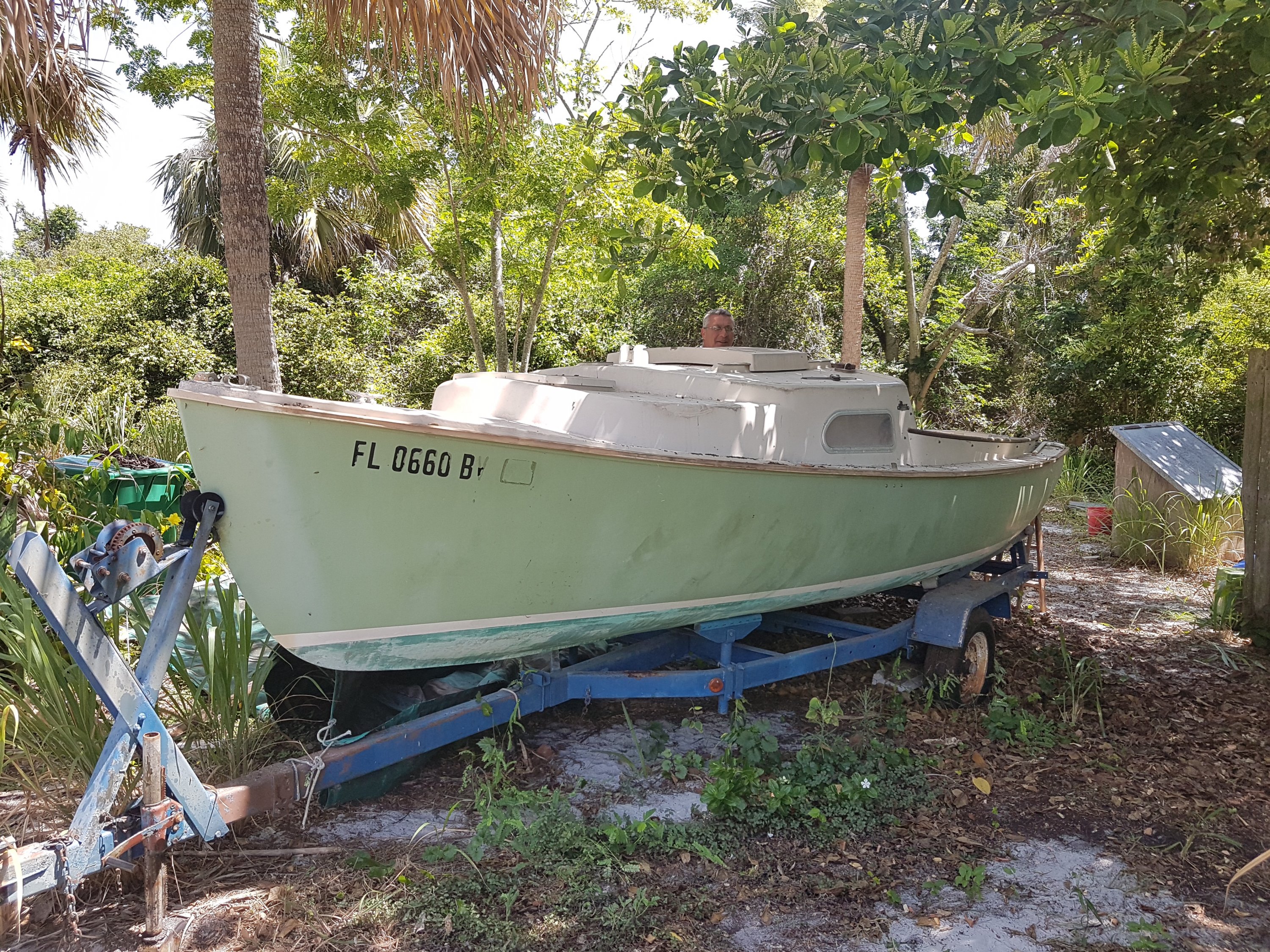

22.jpg ID Plate.jpg That particular shade of green tells me that this is a 1969 or 1970 model. She is a MARINER 2+2 (that's a plus sign, not a 4). The 2+2 version was introduced as a 1969 model (previous model had an open-back cabin with only 2 berths and a non-self-bailing cockpit. The 2+2 enclosed the cabin and added 2 more berths under the cockpit seats. Cockpit was now self-bailing also. This version of the MARINER was built from 1969 to sometime in 1972 when the more modern single level cabin trunk version was introduced as a 1973 model and produced until 1979 (not shown in the 1979 brochures, but several MARINERs were built during the 1979 Model year prior to the first of the new "O'DAY 19" were built.) There will not be a 12-digit HIN on the transom, unless there was one assigned by the State where she was last registered. O'DAY boats built prior to 1972 were marked with a small metal plate (usually on the aft end of the cockpit) that had 2 numbers, a HULL# and a CLASS#. The Class# will be the important one, since that indicates how many Mariners had been built, and that is the number that should key into any model year estimates from the MARINER Class web-site. HULL# on these boats indicates how many boats total (all classes/models) O'DAY had built. My 1969 WIDGEON (12'4") was Hull# 22698 and Class# 1791, that means she was the 22698th O'DAY built and the 1971st Widgeon.

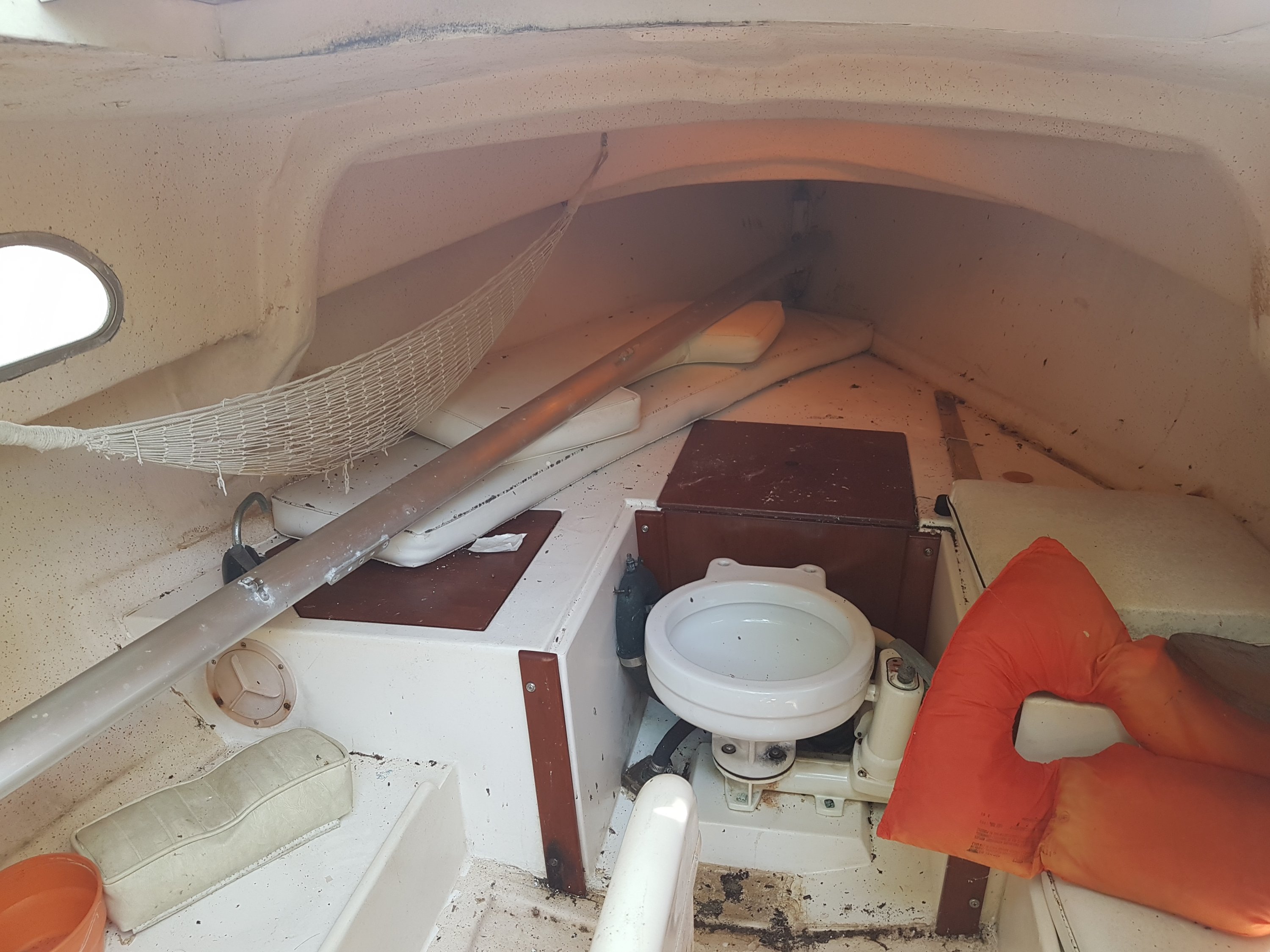

I have seen worse! Much worse! Ditch that marine head and the holding tank. Put in a porta-potty if you need anything. Lots of elbow grease will get-er-done! That will be a fun little boat. Did you get rudder, tiller, sails, mast, and boom? You may need to fabricate some parts and relaminate some decks. Check those decks for water intrusion and rotting. Look over the whole boat for cracks. The trailer doesn't look half bad.
Report back with your findings, and let us know if you need help.

It's all there... even that blue cover for the main sail... it looks brand new. The aluminum masts look great... and the condition of the sails stores in a garage attic for 20 years are shocking.

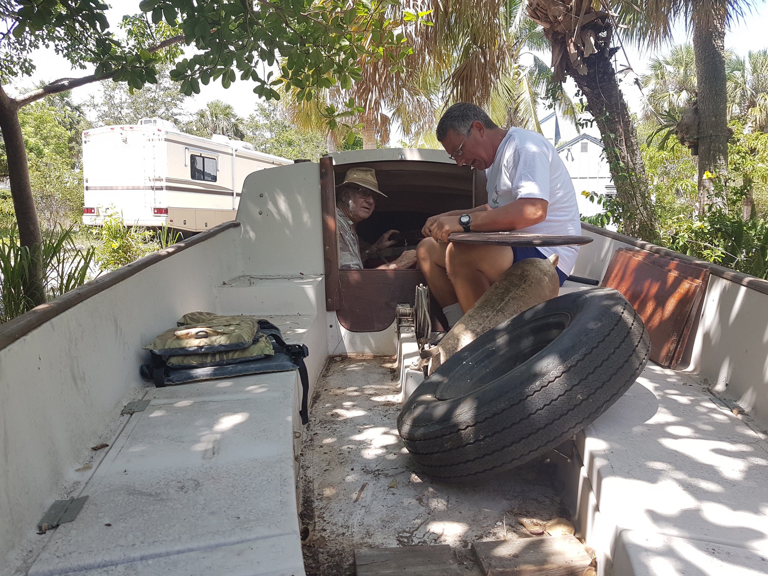

Any thoughts on how to determine it is seaworthy without putting it in the water and sinking it!!! Lol! It has not been in the water in 20 years. We have gone over every inch... banged away... two guys walking all over the topside and in the cabin... no one fell through!

All my wood covers are here... man since 1969... wow... I think this nasty looking bolt is the hinge for the center board... that center board has me quite concerned. Trailer won't let me try to lower it. Have to get inventive to get access. So far my inventiveness has increased markedly. Learned leaving it uncovered in rainy FL... not a good idea in the cleaning phase... or I suspect any other!

You have to get her on boat stands and off the trailer. Check you tube, but you will need some stands.
jwing
Jun 5, 2014
503
ODay Mariner Guntersville
Not necessarily. If you have a forklift or a front loader available (both are rentable), you can use a sling to pick the aft end up while the bow is still on the trailer. You can do the same with a stout tree limb and a come-along.
