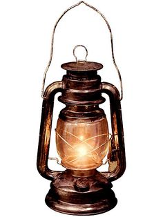

If you have an older, shippy looking boat, a kerosene lantern is visible at 1 mile, the regulation for an anchor light. The Freurhand is a lovely looking option: http://smallcraftadvisor.com/store/product.php?productid=354&cat=8&page=1

Man, that IS a nice looking German built lantern.
And I like that description, "older shippy looking boats". Pretty cool..
