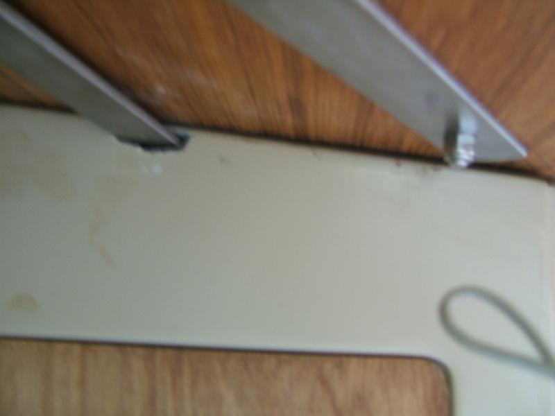

I have already read a lot of posts about chain plate failure and replacement thereof, bulkheads, etc.
I purchased my 1984 O'day 222 about six weeks ago. I am preparing it for winter storage.

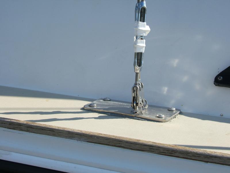

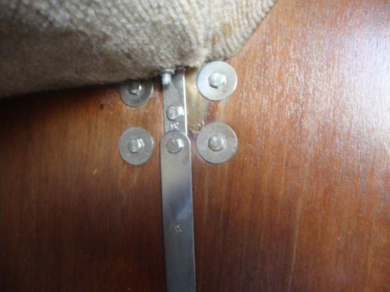

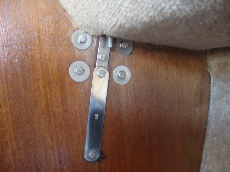

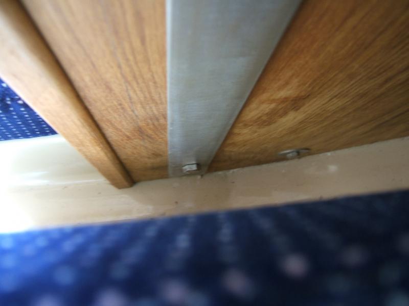

From what I can see, my boat has already had some chain plate work, but it would be nice to hear some opinions. Do they look sound? Please see the pictures attached.
Thanks in advance for your help.
-Dan
Dan,
The fact that that the fender washers are slightly depressed does automatically mean the inner layer of the the plywood is defective. If you tighten the hell out of fenderwashers on plywood they will eventually cause some depression. Plywood, even marine plywood which has no voids, will compress. That is nature of many woods and plywood.
Teak and Mahogany are two woods that are hard and will depress less than other woods such as poplar. But even solid teak can be compressed a little when sufficient torque is applied.
On the repair in question, my recommendation is after mast is down, remove all bolts and inject epoxy into wood area in question. Use thin or penetrating epoxy. And cool conditions will slow the kicking of the epoxy thus allowing it to penetrate deeper.
Once the epoxy sets, allow time for complete cure. In warm conditions, that is 70 degrees F., that is about 72 hours. In cooler temps wait longer. In cold conditions use portable heater if that is available option.
Once epoxy has cured, redrill holes in order to reinsert bolts.
Also, if you want the recessed area around bolts smoothed, do not use just epoxy or epoxy paste with micro spheres, but use glass or carbon fibers. And again not just micro fibers like in the West System Can, but longer fibers of at least 1/2 " or longer. That increases strength of repair substantially.
When using longer strands of fibers the initial repair will look ugly! It will need to faired smoothe and immediate area repainted. It can be made to look good and it will be safe.
