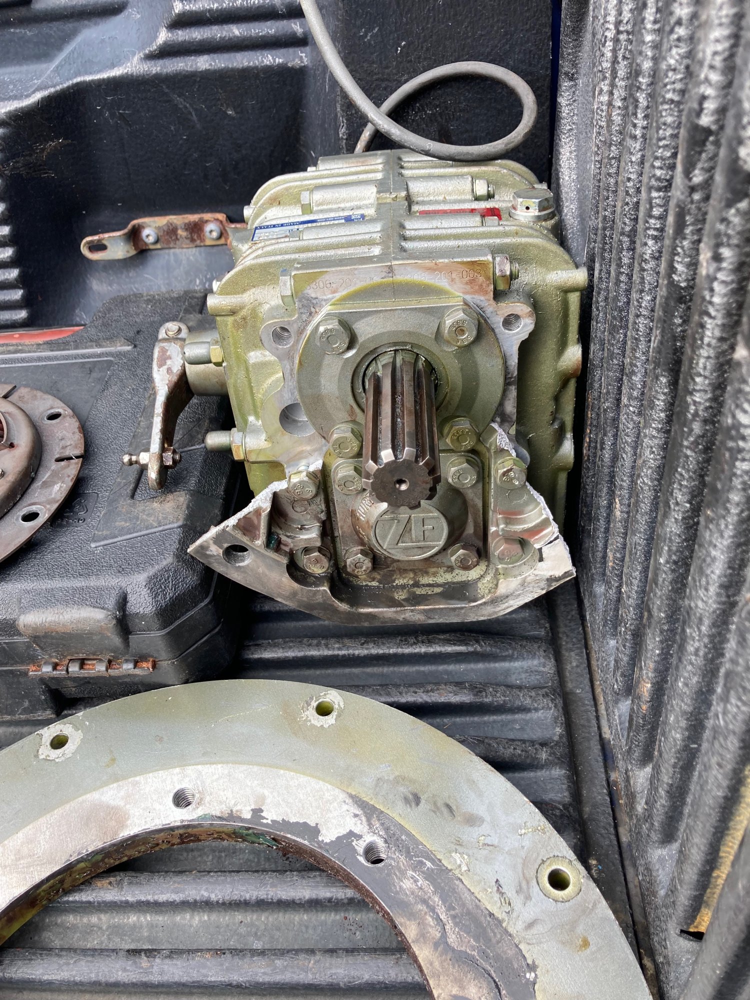

However, while away last year we had a transmission fail and I had a well known company replace the transmission. All was good for a few months and then.
Yep, that's the new transmission. The mounting plate bolts came loose, the plate cracked and the transmission fell off the motor. Why did this happen? The wrong diameter bolts were used to mount the transmission to engine. Apparently the technician used metric instead of SAE bolts or vice versa. The bolts felt tight, but they obviously were not. Also the shift cable was not properly adjusted causing the clutches to slip. With only a couple hundred hours on the transmission, it needed to be rebuilt.
The original did reimburse me for the repair, although not for all the other expenses like a hotel room for over 2 weeks and a car rental.
