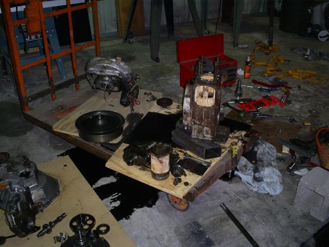

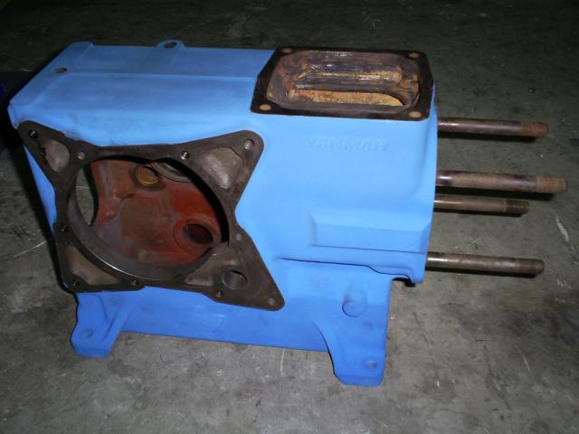

If you look in the top left of the exploded engine you will see one of the main bearings in the center of the aluminum case. The other is the engine block that has one pressed in it. I couldn't budge it with a 5 ton press. It takes an incredible amount of force to get them in and out.
