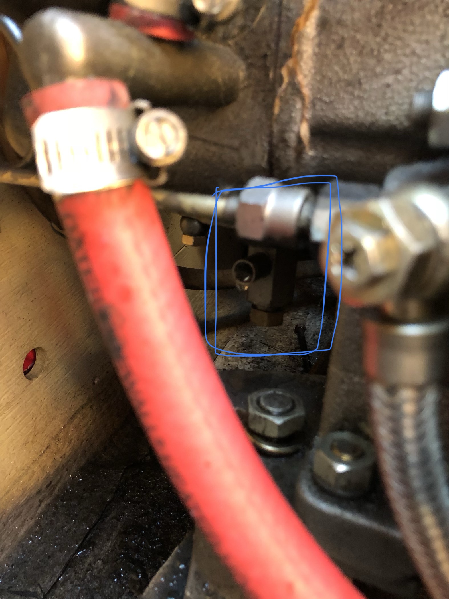

Hey everyone - do you have any advice on how to correct a leaky draincock assembly? I'm convinced it's not putting my vessel in immediate danger (above the water line and connected to an unlikely source of flow-through lake water) but I'm also convinced I can't run the motor for any length of time with this much water pouring out of the nozzle.
I searched this forum as well as my manual but there's no reference for identifying if it's a failed valve or just needs to be tightened or what. I tried to tighten it and damn, it won't budge at all.
Photo attached. And here's the replacement (I think) but mine looks identical, no way to know if there's something faulty inside I guess.

I have a YSM-12 on my sailboat. Don't know if you normally use the motor drain cock but here on our West Coast we sail year round and don't do "winterizing". A few years ago I loosened the drain cock and no water came out. It was full of rust. Just unscrew the whole assembly, soak it in solvent, disassemble and clean it out. If it is FUBAR, just replace it with a bolt with the matching threads and length.

Thanks jalapeno, that's basically my plan. Since I'll only need to remove it to winterize at the end of the season I'm hopeful that works.

If you do replace with a bolt, I'd suggest painting the bolt head red so you remember to take it out in the Fall when you winterize the engine.
