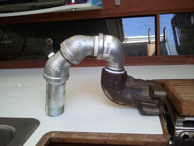

Needed is a 1 1/2 inch galvanized 90 degree elbow with 3/4 inch port
for engine exhaust water. I am rebuilding my exhaust system and can't find the elbow.

Like this little beauty? My branch for the water injection is 3/8" pipe thread. I drilled a 9/16" hole in the side of the elbow and bought a 3/8" NPT tap to thread it. Pretty easy actually. All of this was available at my local hardware store.

My atomic 4 came with a similar setup and it worked fine for years judging by the corrosion on the inside when I pulled it for yearly maintenance.

Thanks so much. On my way now.
