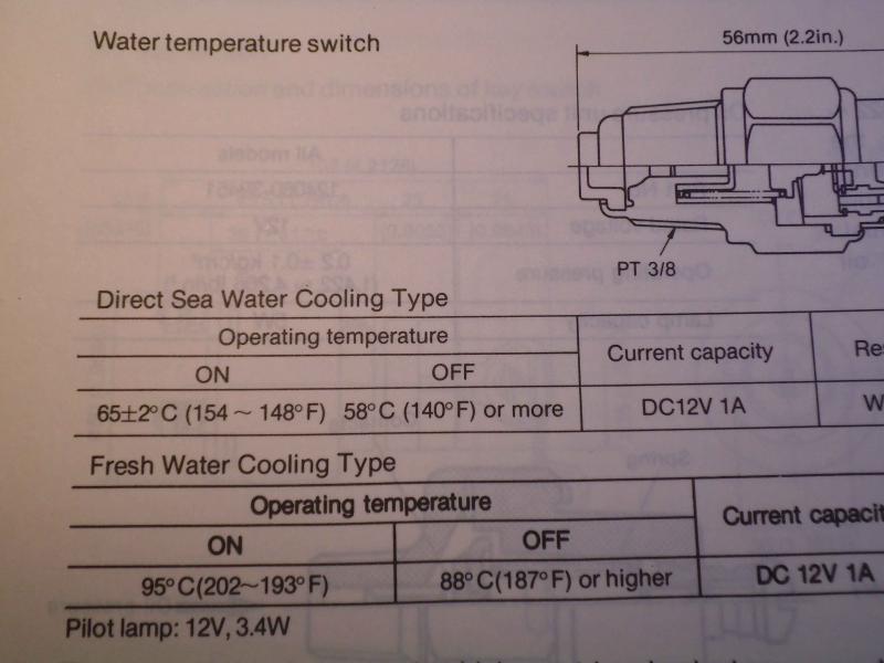

Good observation. But I think we are both right. My 2QM20 manual is on my boat so I can't double check that. However, I do recall a thermostat spec in the 140F range.
I do have at hand a GM series manual. (My PO had this on board instead of the QM series manual which is the engine on the boat!)
Here's a pic of the Yanmar service manual temp switch spec's for both the GM series fresh water (self contained anti-freeze) and seawater versions. The alarm goes off between 148F and 154F. Resets (turns off again) and 140F. I know that for the QM series, the switch has a yellow instead of a white dot. The yellow dot version alarms about 10F lower than the GM's white dot one. This I think is the reason that my QM temp alarm sometimes goes off. Thermostat operates nearer the 140F. Alarm switch triggers not much higher. This happens after I've run the engine for a while, then shut off for a few minutes, then restart. I think that without the coolant water flow, the core heat from around the cylinders radiates into the block and heats above the alarm switch trigger point. After a minute or two of resumed operation and coolant flow, the alarm stops. I have been thinking about getting the higher threshold GM switch to replace the one that I have.

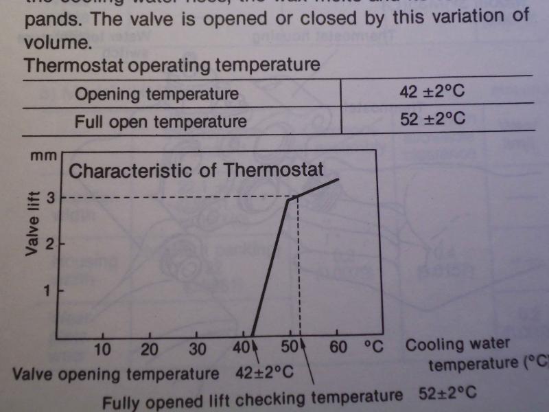

Also attached is a pic of the the GM series raw water thermostat spec. Yes closer to your 105F.
Anyway, not withstanding the actual degrees F's, my previous comments about being careful about doing any alarm / sensor conversion still applies, I think.
And yes, my temp gauge pointer doesn't move up much. Only to about 130F or so. But it's handy to have because if the alarm goes off, I can look at the gauge to verify that the engine is not overheating.
