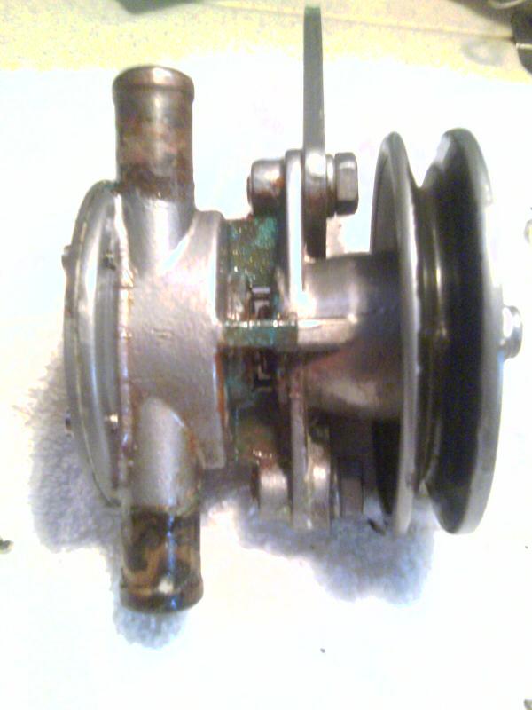

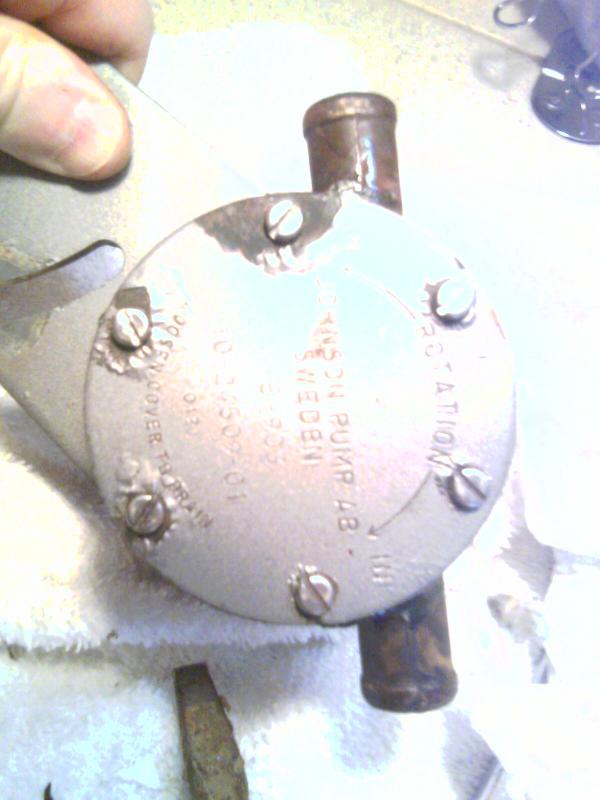

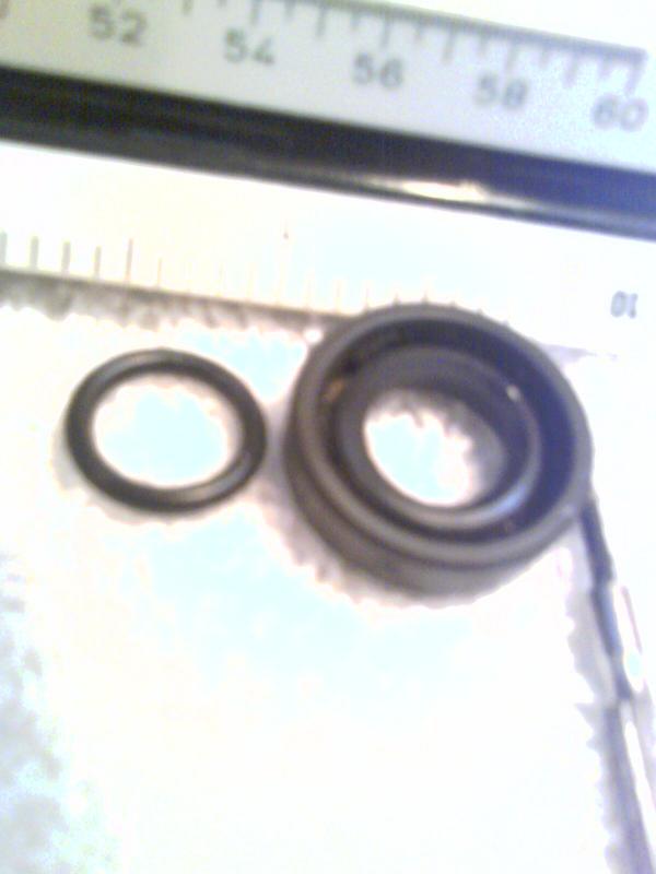

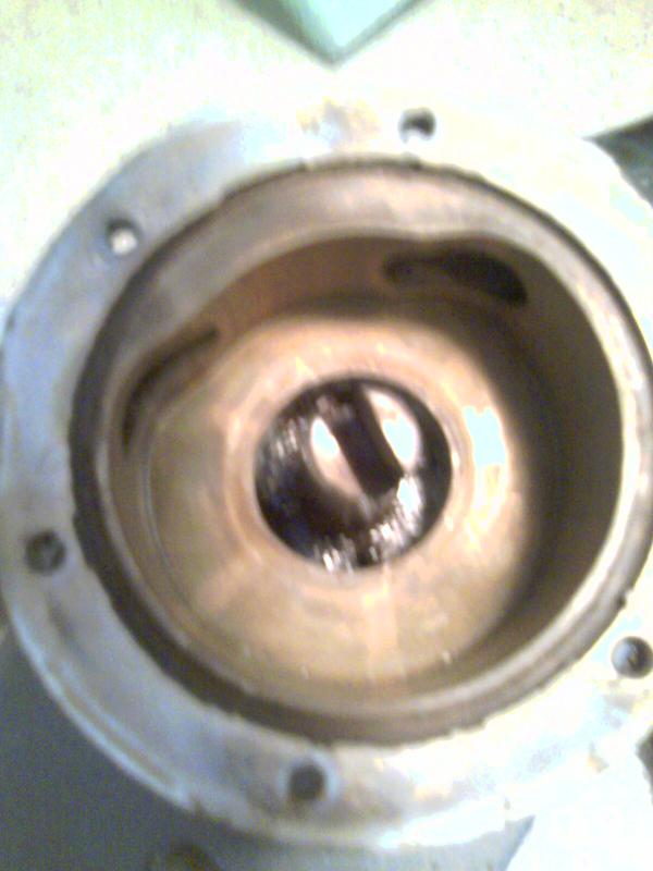

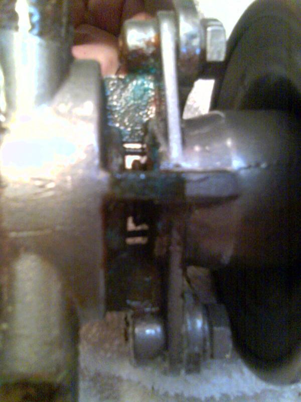

Here are some pictures of my pump that I had to service just this past summer. BTW..Lessons learned don't ignore that small drip. So just as you clear the marina entrance you have a total failure.
The spring in the rubber ring seal needed tightening just a bit. Was able to get the rubber "o" ring in and over the spring ( or was it under ??)to increase the seal tighteness to the shaft. I figured this out after I had just bought a new one. Its still working so the new one is just saved as spare for now. I hope the pictures help. It really was not that hard to fix.
