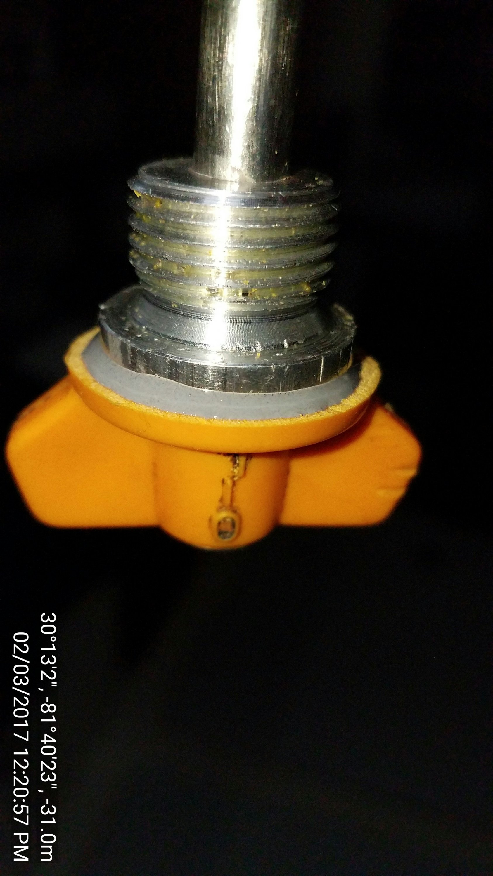

If you have a GM series yanmar with the kw tranny and your dipstick has the yellow plastic threads you might be interested in this. I have had the threads stripped to the point that the dipstick needed replacing. I'm pretty careful when threading being that the soft plastic is going up against an aluminum housing. After a little research, I found the problem to be fairly common.
To avoid plastic altogether I found an iron drain plug that would fit but I gave up on trying to drill a 1/16" breather hole in it. I finally found an aluminium plug made in Germany for Porches. See link: http://www.5150motorsport.com/oil-drain-plug-m18-x-1-5mm-900-219-020-31.html. It's around $8 with shipping. Fits perfectly and was easy to drill the breather hole. Came with aluminum gasket. Even if you don't need one now would be useful as as a spare. I kept the old stick for measuring.

After about 20 hours of run time using the aluminium plug with 1/16" hole drilled in the top, I found that a substantial amount of oil was escaping through the hole. I'm either drilling a smaller hole or attaching some type of standing pipe with a breather hole cut in in the side. The top end will be capped. Any thoughts other than the obvious: Just buy a new!

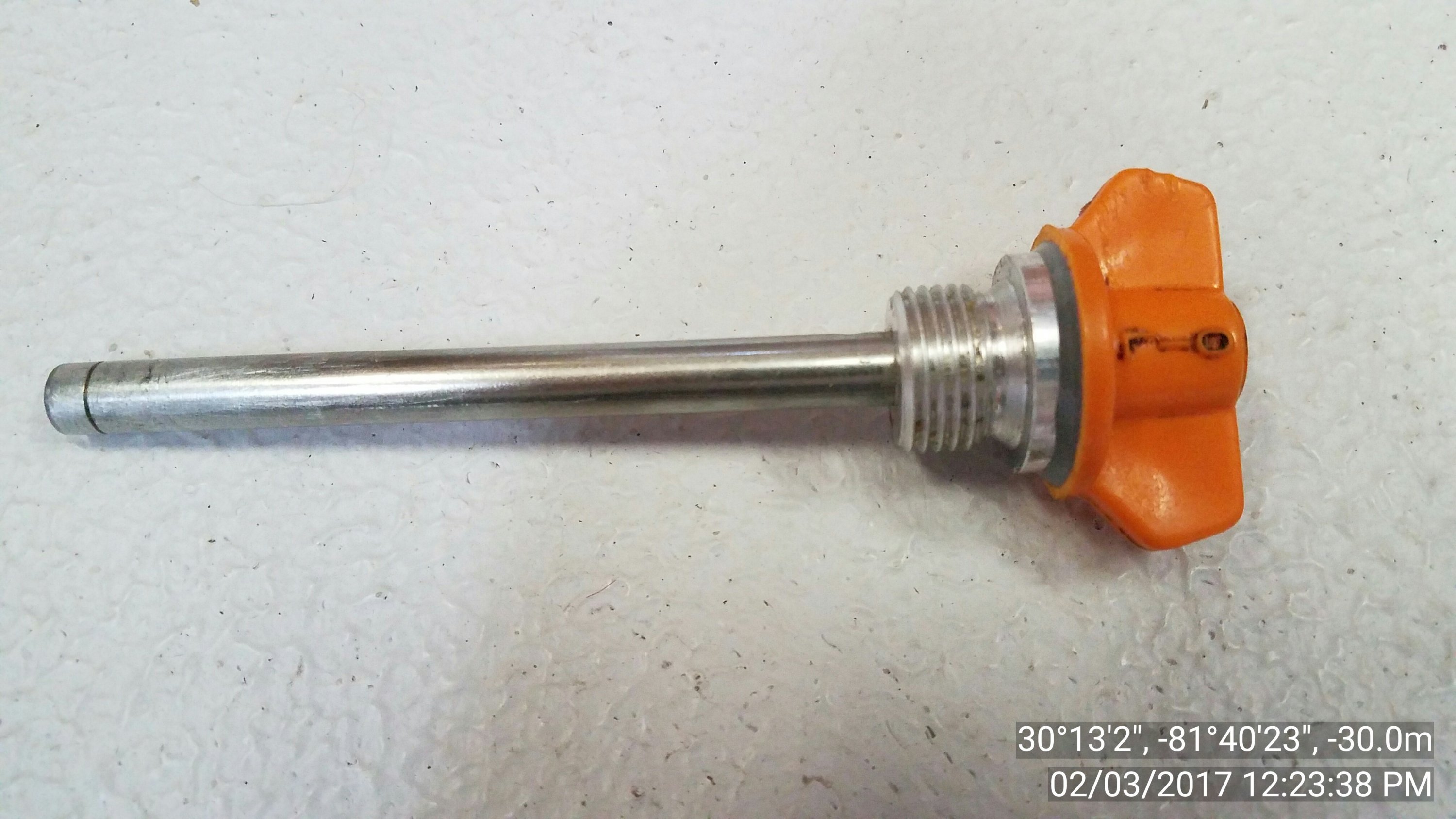

Follow-up on my original post. Because the aluminium plug was spitting out some oil even after drilling a smaller breather hole, I decided on a different approach. I took the Porche plug and drilled a hole about 1/64" smaller than the original Yanmar dipstick measuring probe. Then cut off the orange plastic threads with a hacksaw. Taped the dipstick through the aluminum plug until it bottomed out. Put some JB Weld between the surfaces before closure. Picture shows it better than I can explain. Basically, I'm replacing the plastic threads with aluminum ones.
