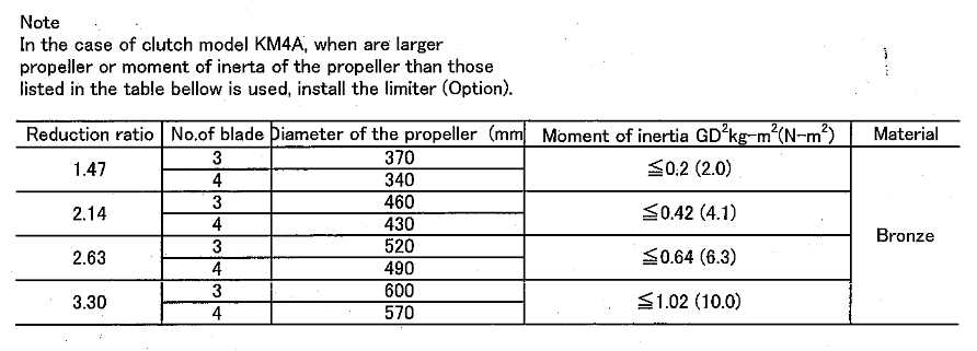

I would never have guessed the ratio would be 2.63, but when my engine was running, my boat typically did about 7 knots at 2800 RPM. That is just about hull speed and I rarely exceeded 2800 RPM. My trans is KM4A #6078. We assumed that #6078 is the serial #? My next steps were a call Hunter and possibly pushing the prop shaft back to remove the trans. I was digging out my original owner documents to try and find the engine serial number, the plate is missing. But I think mistralseattle’s info sounds correct as the RPM to speed thru calm water matches my experience perfectly.
