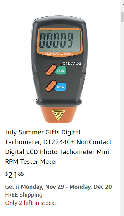

It's also a good idea to invest in an optical tach. Any VDO can be setup without a tach but it's always nice to run a check every few years. You want the cheapest handheld tach you can find with no bells and whistles. This is identical to the one I bought about twenty years ago and paid about four time as much.
I'd suggest getting the optical tach first and checking your currently installed tachometer.
