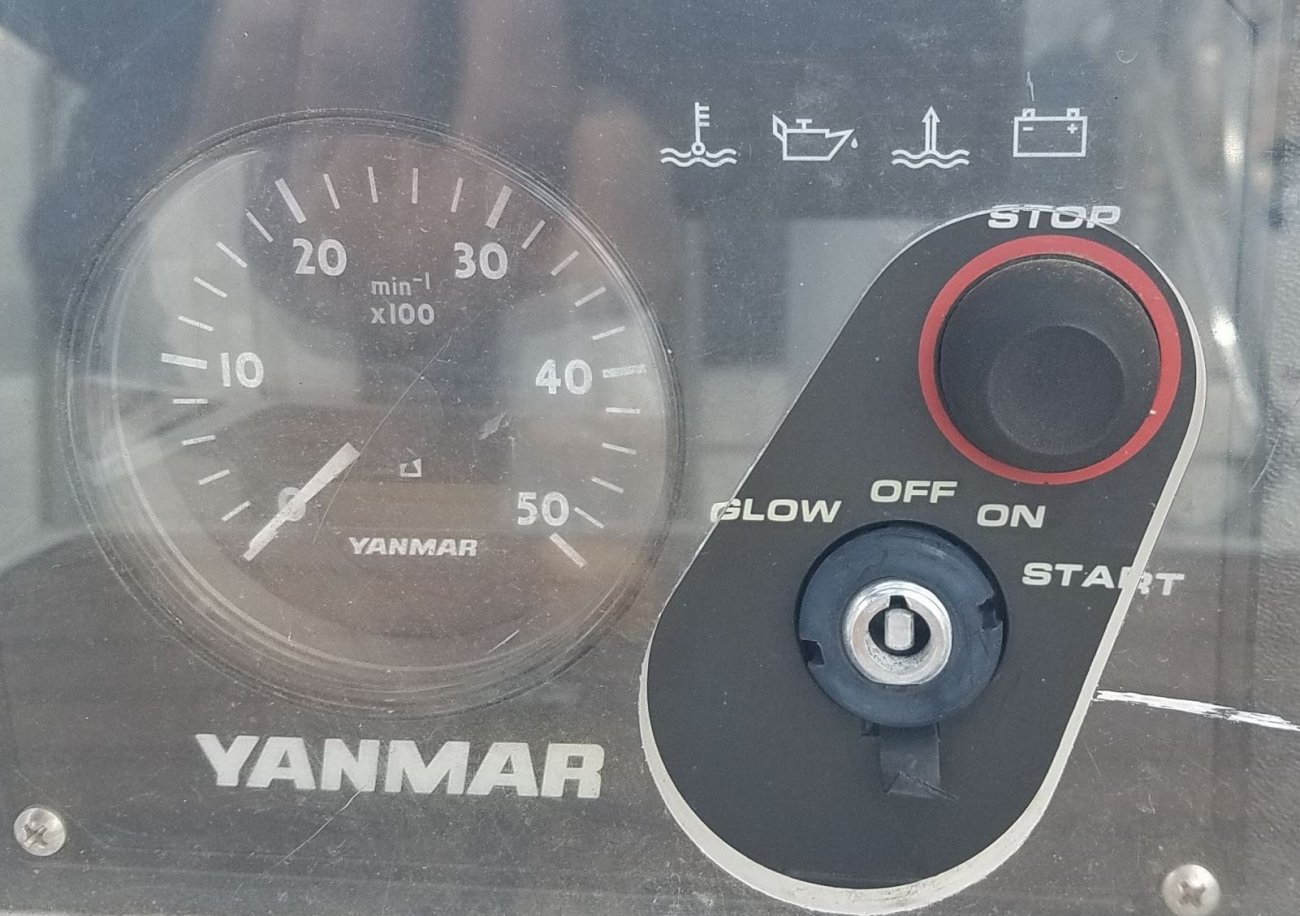

I started my Yanmar (3JH4E) after winter storage and it cranks over, but will not stay running. The key was in the "ON" position, and oil pressure alarm works. After several attempts, I found that if I start the engine and quickly switch it to the "OFF" position, the engine will run as normal, however none of the gauges work. The engine/transmission function as usual. To stop it, I turn the engine to "RUN"
I had this issue last year after storage, and suspected the ignition switch, before I went to replace it, the problem went away. All the connections appear in good shape. Has anyone seen this before?
