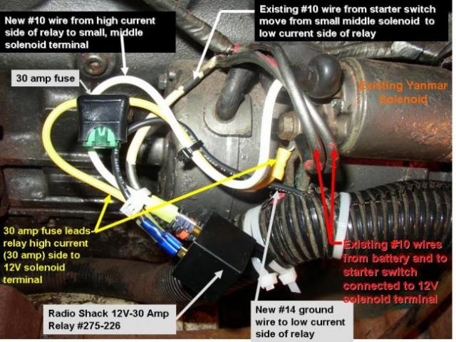

I am getting around to putting this relay in to improve the operation of my starter button. Does any have a link to an exploded diagram of a Yanmar 3GM30F engine starter and solonoid. I haven't been able to correlate what I see on my engine with various instructions I've received. It is difficult to visualize the wiring on my engine for various reasons. An exploded diagram would help a lot.

Thanks, so much. That is so far better than I hoped for. I'm a bit stunned.

Just an update for those following this. I have accomplished the installation of the relay and now the starter button is working again. It had stopped completely causing me to have to start the engine by jumping the solonoid with a # 10 wire. It was an act I liken to trying to do surgery on a patient having convulsions.
Thanks so much to those who lent their opinions, advice and especially photos.
I am a big fan of the kiss rule. This solution has kiss appeal even if it doesn't pass muster as a solution that has the fewest weak spots. I really didn't want to replace the whole harness with all the other wire connections. A replacement wire can still be done if necessary. At least I understand the problem and don't have to chase dead ends like replacing the starter button, buying another new battery etc. That's worth a lot.
