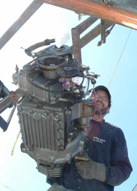

I welded up a U-shaped bracket so that I could lift from the center of gravity of the engine while clearing the companionway(pic, not me!). That's my 2QM20 coming out. It has a new home in NJ in an H27.
