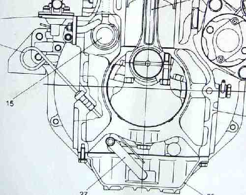

As a new owner of a '99-310, I have changed the oil on the 18-hp. Yanmar 2GM on two occasions: Before a 6-day motoring up the ICW (no previous record of last, or any, oil change)and at the end of this trip wherein the gauge read 479 hrs. After each oil and filter change I discover a large quantity of oil in the bilge indicating overfilling of the oil. The recent oil change started with the dip stick registering a spot of oil at the very tip of the stick. Removing the old filter we encounter 1/4 qt, or less, old oil. Using a Jabsco hand pump with extraction tube in the dip stick hole we pump-out less than a quart as it seems there is no more oil in the engine sump. Adding 2-quarts of fresh oil and a new oil filter we then check the dip stick and note oil to the top notch of the dip stick.After uneventful motoring for 2-hours, we shut down for the day and discover at least 1-quart, or more, oil in the bilge that was throughly clean before motoring. I sense the "Jabsco" method is both messy and inefficient (I'm new to sailing)and we are not extracting "all" the oil from the sump. I also question the reliability of the dip stick marking. In the meantime, the engine runs efficiently and does not overheat....although it appears to do this with about 1-quart of oil. Please respond if you have any good advice. I would like to spend less time removing oil from the bilge.
