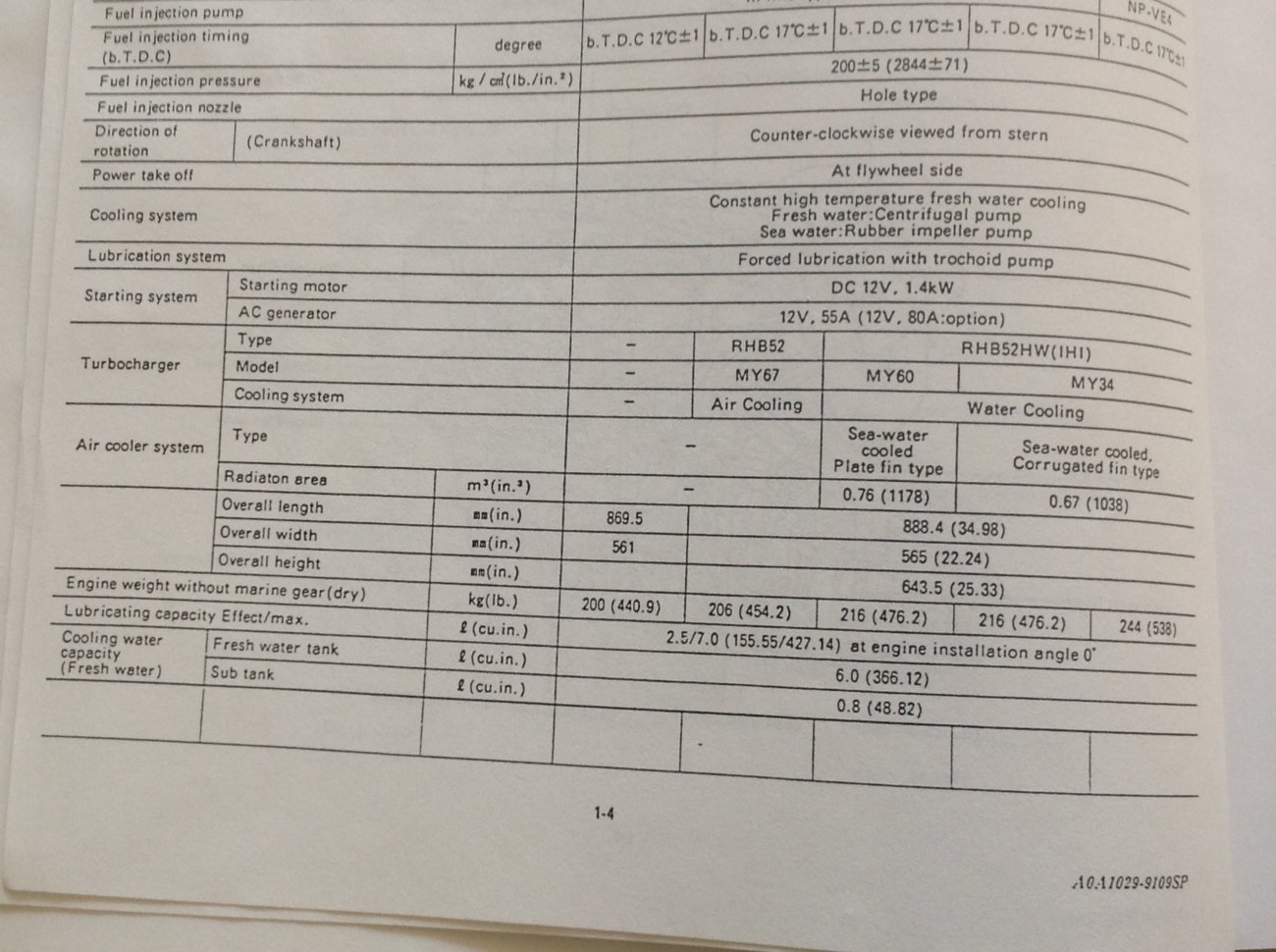

IMG_0555.JPG See Yanmar service manual which indicates oil capacity is 7 liters, not quarts.

View attachment 157344 See Yanmar service manual which indicates oil capacity is 7 liters, not quarts..
True, quarts and litres as words often get used interchangeably for Canucks like myself as they are only 54 ml apart in volume. However, 7 quarts is 6.6 litres so less than the pan capacity. Also I replaced what I had put in (I always measure what I take out), and had the dip read on the line before the oil change. After the change it was on the line as best as I could read. Hence the confusion and why I posted originally.
